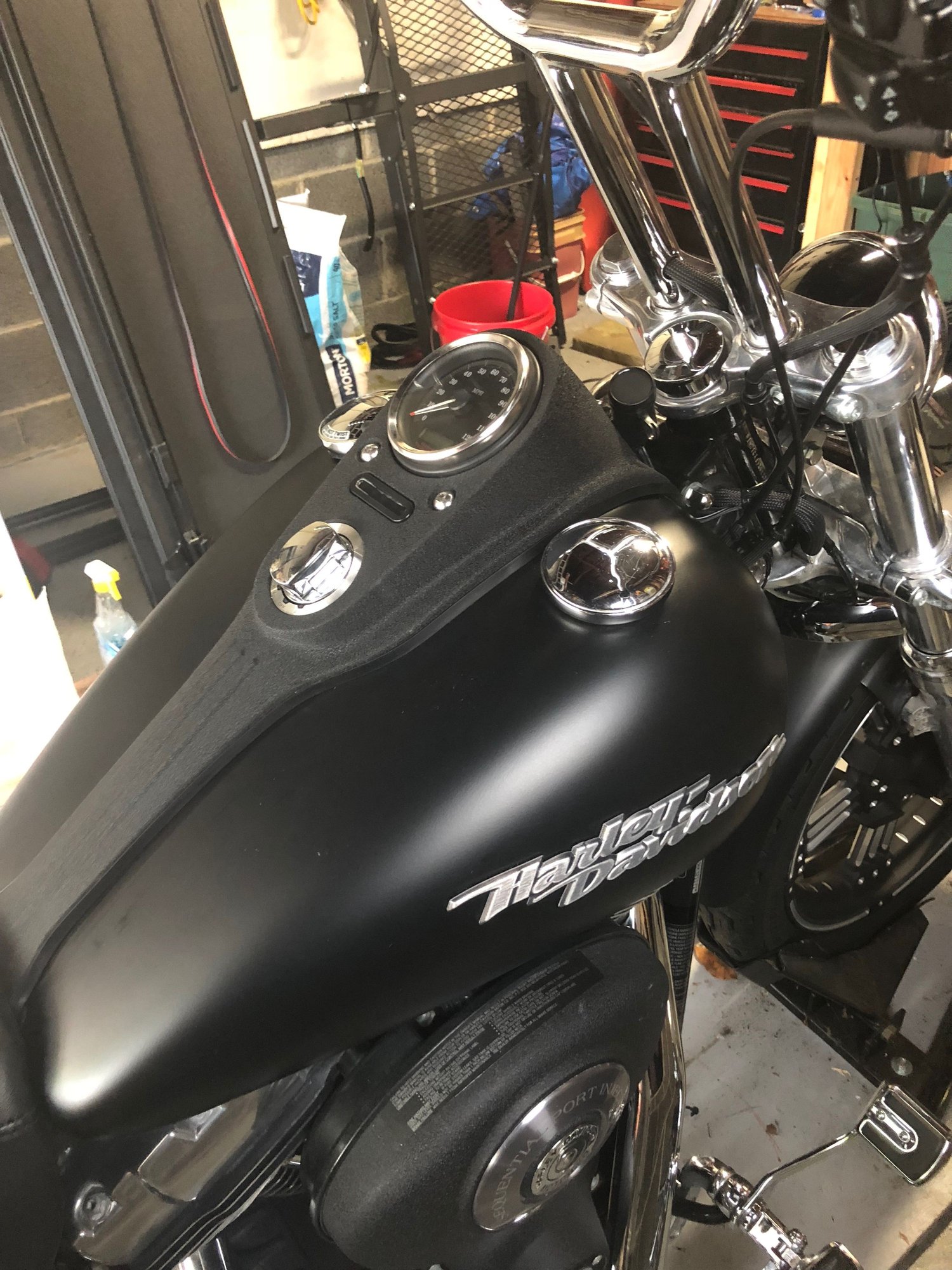

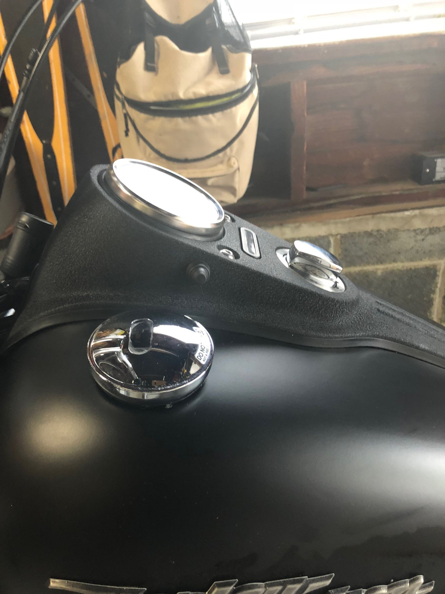

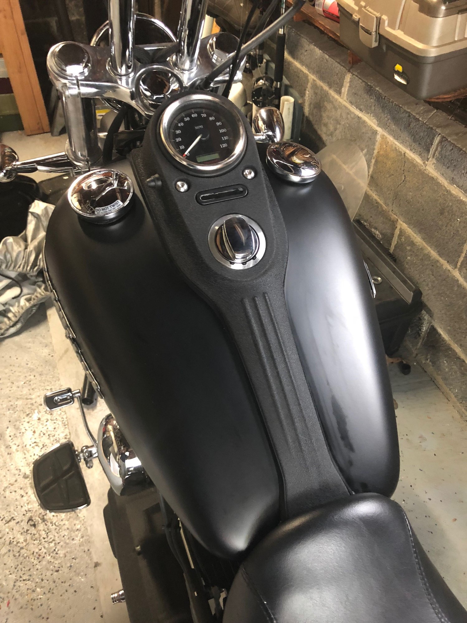

Ok I just wanted to give everyone an update since a lot of people viewed this thread but nobody replied. I also saw the same questioned asked in other threads, never with a reply.
I took the gamble and purchased a dash from a new street bob with the ignition switch from eBay and it fits! I purposely bought one that was dinged up at a super cheap price incase it didn't fit. A little auto body work and VHT wrinkle black paint( Perfect match) and good as new.
To hold the switch in place I made my own bracket out of some sheet metal mostly because I didn't want to wait to buy one form the dealer. You will also have to drill a hole for the trip reset switch.
I purchased the switch for $60 because it was a combo with a new fork lock. Sadly I didn't realize how big of a job the fork lock was and the cylinder did not fit any way so I only did the switch. I took the rubber off the stock key. No big deal for me, in 12 years I have never used the fork lock once and I also have the security system. If it is that important to you purchase the ignition switch from Harley with matched keys.
