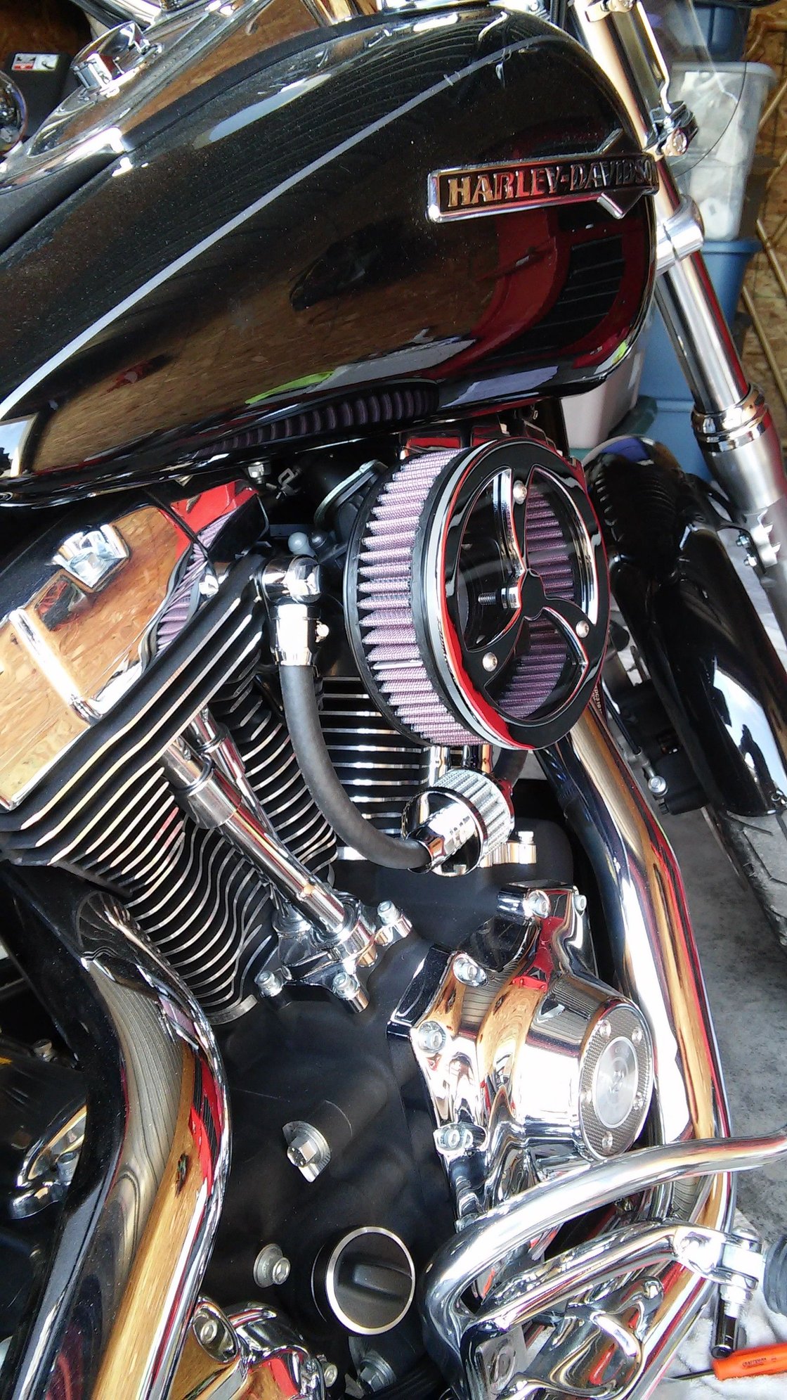

Yeah, that air cleaner was a huge problem for me as well. I have a Wide Glide with forward controls and every conventional air cleaner I tried dug into my knee uncomfortably or was just plain awkward. In most cases, they forced my foot to slide out on the RH peg and made toeing in to reach the brake pedal very awkward. I'm not bow-legged at all. Not exactly knock-kneed, but definitely not bowed.
The Heavy Breather style air cleaners were a good solution for me. I no longer touch the air cleaner with any part of my leg and I can easily pinch the tank with both legs.
DK Customs' 636V air cleaner is extremely popular (and my personal preference among commercial offerings). The Heavy Breather is very popular as well. K&N also makes a version.

I see how the 636V air cleaners and others like it would remedy that issue. Not fond of the look, but here it would appear practical.

Take a look at DK`s Cyclone. It`s no where near in the way for me with mids or further forward mids. Don`t know about forwards.

I’m running the DK Customs breather kit with the the old round evo air cleaner cover and have zero issues clearing the a/c on my Superglide and I’m running floorboards
same setup on on my wife’s switchback and she was no problems now, with the stock filter it was in the way of her leg
