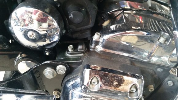

I had a ghost drip like this on my 2003 Low Rider. used the UV dye and black light and traced it back to a bad o-ring on the sensor (speed sensor?) on the right side below the battery towards the back of the engine on the top. might be worth trying the dye. it is cheap enough, and you can narrow it down to one spot for sure. this guy right here, leaked and ran down across the bottom of the pan and dripped. a spot about like a 50 cent piece every time.
