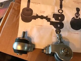

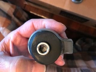

Anyway, here are some pics of the culprit. The picture of both halves I have the left side oriented wrong, it is upside down. If the resolution of the pics is god enough, you can see the damage to the left side of the link where the rubber and aluminum have been hitting my fuel tank for too long too many times:

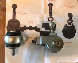

Here is picture of link with correct orientation of parts in side view on manufacturer-supplied drawing of the link. The center portion with the adjuster nut and threads that should go into the left end are gone dowwn some road somewhere. I sheared off at the end of the threads on the right half just before where the adjuster nut should be.

I don't see how that CCE link is any better than OEM except perhaps in length adjustment. It also looks heavier but that wimpy jack screw (appears broken on yours) is pitiful. The OEM link is also rubber bushed...and doesn't seem to ever break. Main reasons why we change out the OEM link is to get easier and more accurate length adjustment (better alignments) and to remove the rubber bushings (more control over drivetrain motion). Removing the bushings also means slightly more felt vibration but that's considered a fair trade for improved stability and control.
There's honestly nothing wrong with the OE link if you're OK with how the bike aligns and handles. No reason to change it unless you're looking for that last couple percent improvement. I think most people that go to a proper heim jointed link setup are riding in far more sporting fashion than the average Dyna owner.
As to what caused your mix of failures... I'd say they're probably unrelated. The front lower mounts are very prone to degradation and early failure. Many insist that oil contamination from the filter changes are blame but some just fail early.
Your CCE top link looks like a poor design where the bushings don't allow enough compliance which stresses the little jack screw to failure at the threads.
