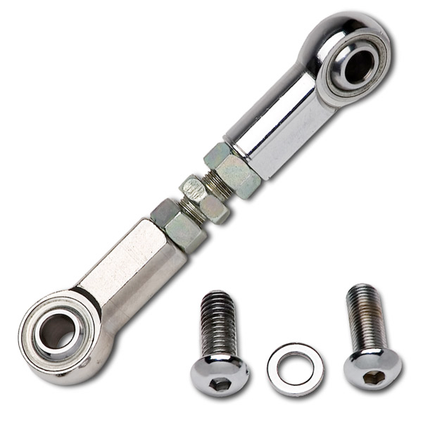

cggorman, I ordered the link pictured below from J&P because it has the turnbuckle style where you don't have to detach one end from the bike to adjust like the OEM. I am not doing adjustments/alignments on my bike, I don't have the proper tools or patience anymore. I think Ive finally found a good mechanic I can trust so I will pay him to deal with it. I can't believe CCE charges over $320 for that link now that I've had it and it failed! Seems to me like you said the thread sock is too thin, ought to be maybe as much as twice the diameter. Sometimes the weight shouldn't matter so much. Bearings I also pay mechanic to do but the first change a couple years ago was at a shop that specializes in Japanese bikes but I was in a hurry to get new tires before Memorial day weekend 2018 and the guy I took it to before didn't have time and when the other guy found the rough bearings I said go ahead and change them. Turns out he didn't eve do the work, he had a buddy of his come in who happened to have the tools needed for this specific bearing job but the guy wasn't a Harley mechanic either and he was bitching at me when I went to pick the bike up telling me Harley design sucks and the bearing were designed wrong, put on wrong, blah blah blah, and while he is yelling at me I see from 20 feet away a flat spot on the side of my tank that I had just 3 months earlier found a nice set of used tins to replace what came on the wrecked bike which I bought with salvage title because I'm too poor for new bikes. The flat/dent on the tank wasn't there and I had just washed and rubbed down every reachable spot on that bike the day before I took it to them. SO I had a nice tank for 3 months and they denied doing the damage and I didn't have the money to fight them in court so I got f*cked and paid for bearings that lasted 20,000 miles. The new mechanic was asked to use the best bearings and all the customers I have seen at his shop have nothing but good things to say about him. I just wish he had the fancy electronic testing equipment that the big shops have but oh well. Here's the pic of new link I ordered. And it only cost about 1/5 what CCE's cost! Sorry for rambling.

I don't know much about working on bikes and I only started riding late in 2017 and never worked on a motorcycle at all before then ever. SO I was naive and took the advice of the mechanic i went to a couple times before deciding I needed a different mechanic. Ignorance is no excuse but I was ignorant, still am to some extent but hey, sh*t happens. As for that CCE mount/link, I sure looked fancy compared to the OEM! Live and learn. I just wish living and learning wasn't so expensive. The alternative to living is unacceptable.

That J&P link looks roughly comparable to the Chevy alternator link that's become popular. Should be OK. Depending on the materials used, you may find it necessary to oil the heims once in a while to keep them quiet.

Looks like a solution in search of a problem...
If you make something so complex that people have trouble understanding its purpose, you can charge a lot more for it...
Those of you who are concerned about the factory part requiring you make adjustments in 1/2 turn increments, just an estimate, but, if the thread is 16 tpi then a half turn is about 0.1 degrees.
