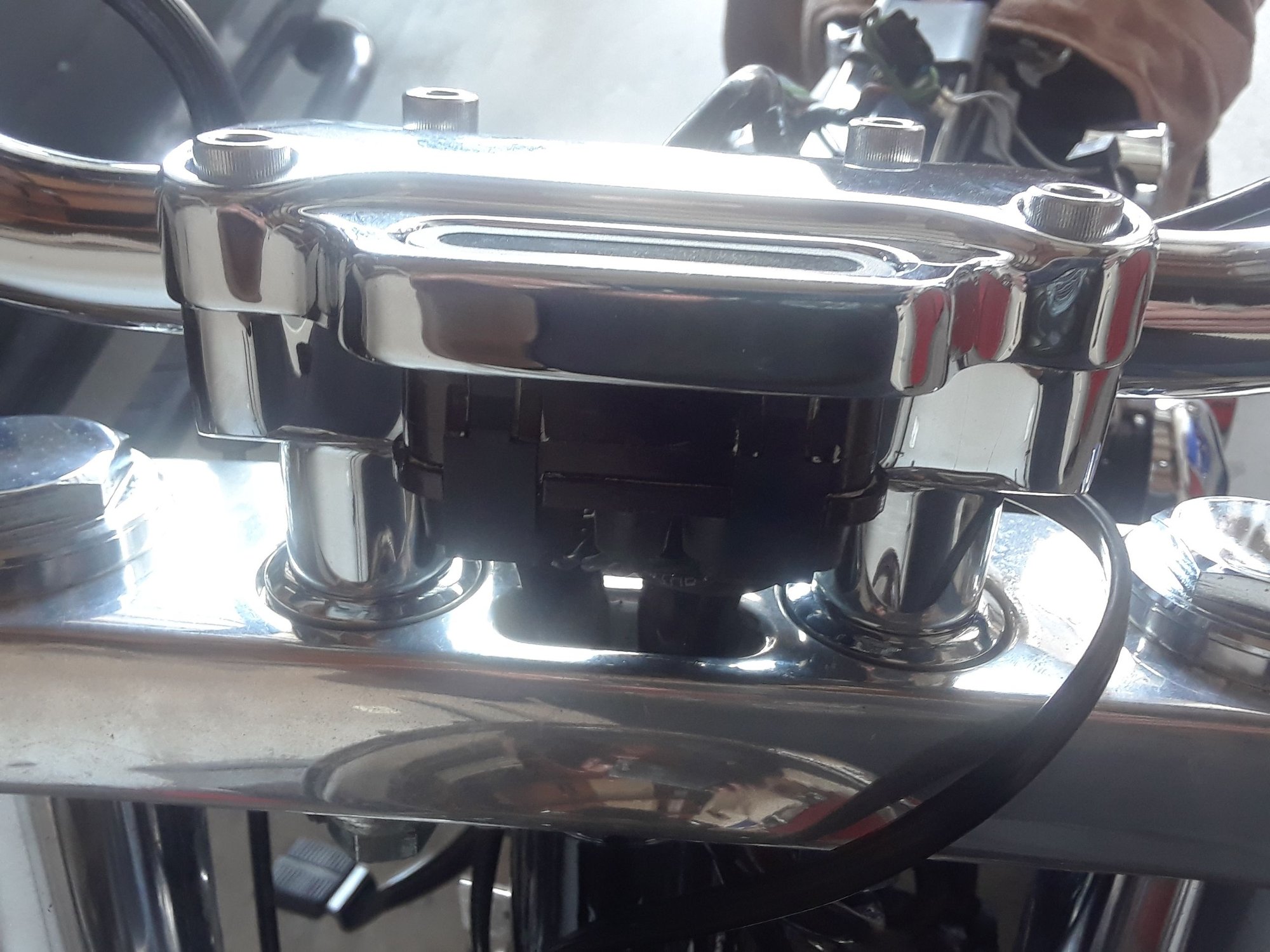

hi all, i'm wanting to install the streetbob 10" apes on my 06 lowrider with short risers. i don't want to reuse the 4"curved stock risers.
how do i remount the
idiot lights that are mounted in the top clamp back on ? the top clamp dosen't have the same bolt pattern at normal short risers. any ideas ?

Necessity is the Mother of Invention. Yer gonna have to think outside of the box on this. Looks like the idiot light panel is part of the upper handlebar clamp. I would say have a machinist make you some new straight risers with a bolt pattern to match the upper clamp. Good luck.

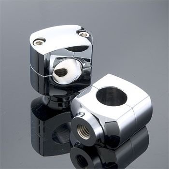

i wonder if my top clamp would fit on these ?
Looks like a match.

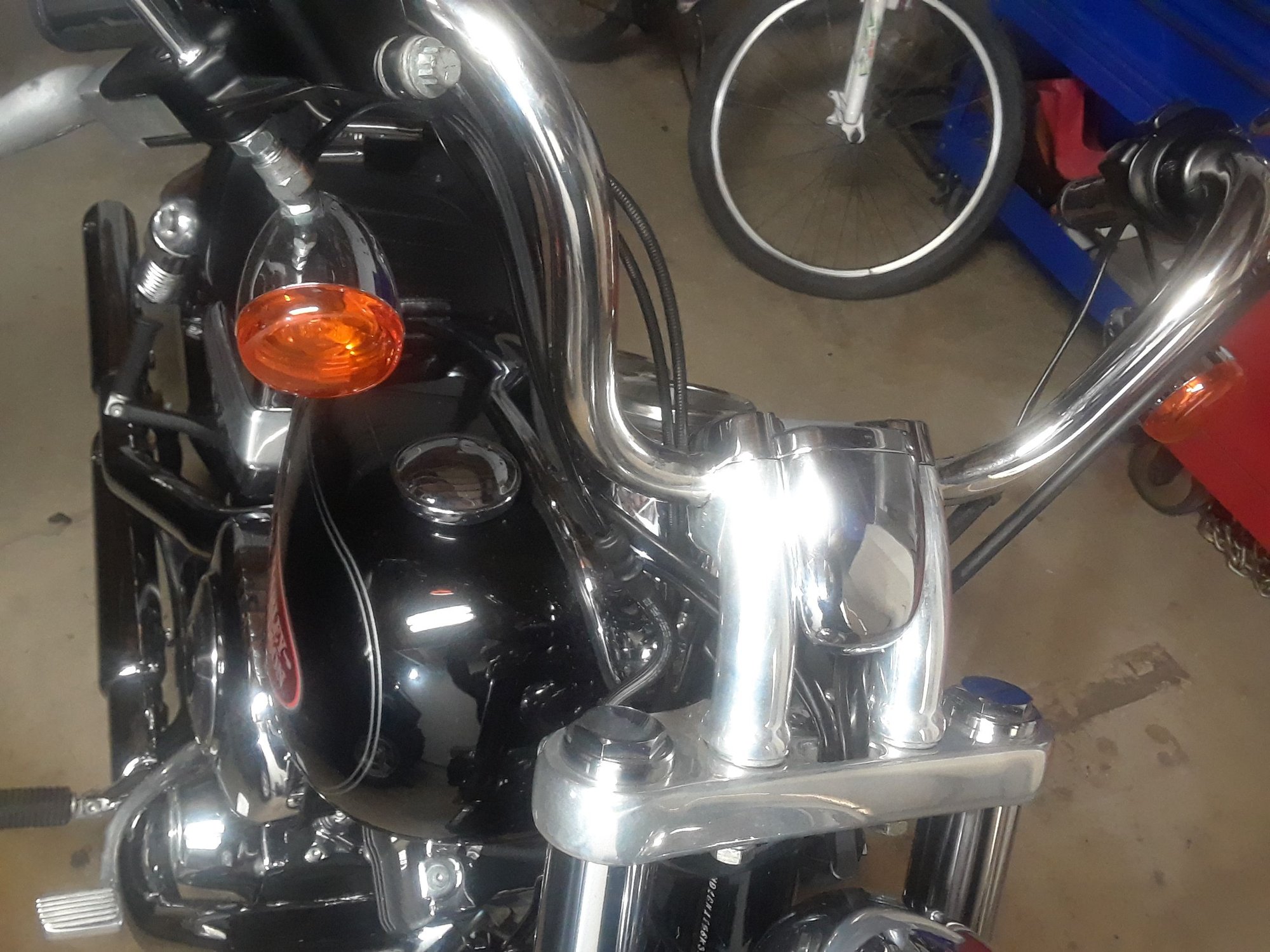

Smile
finished the job, looks a little weird in the front
cause you can see the wires going to the idiot lights ,but it's functional.
