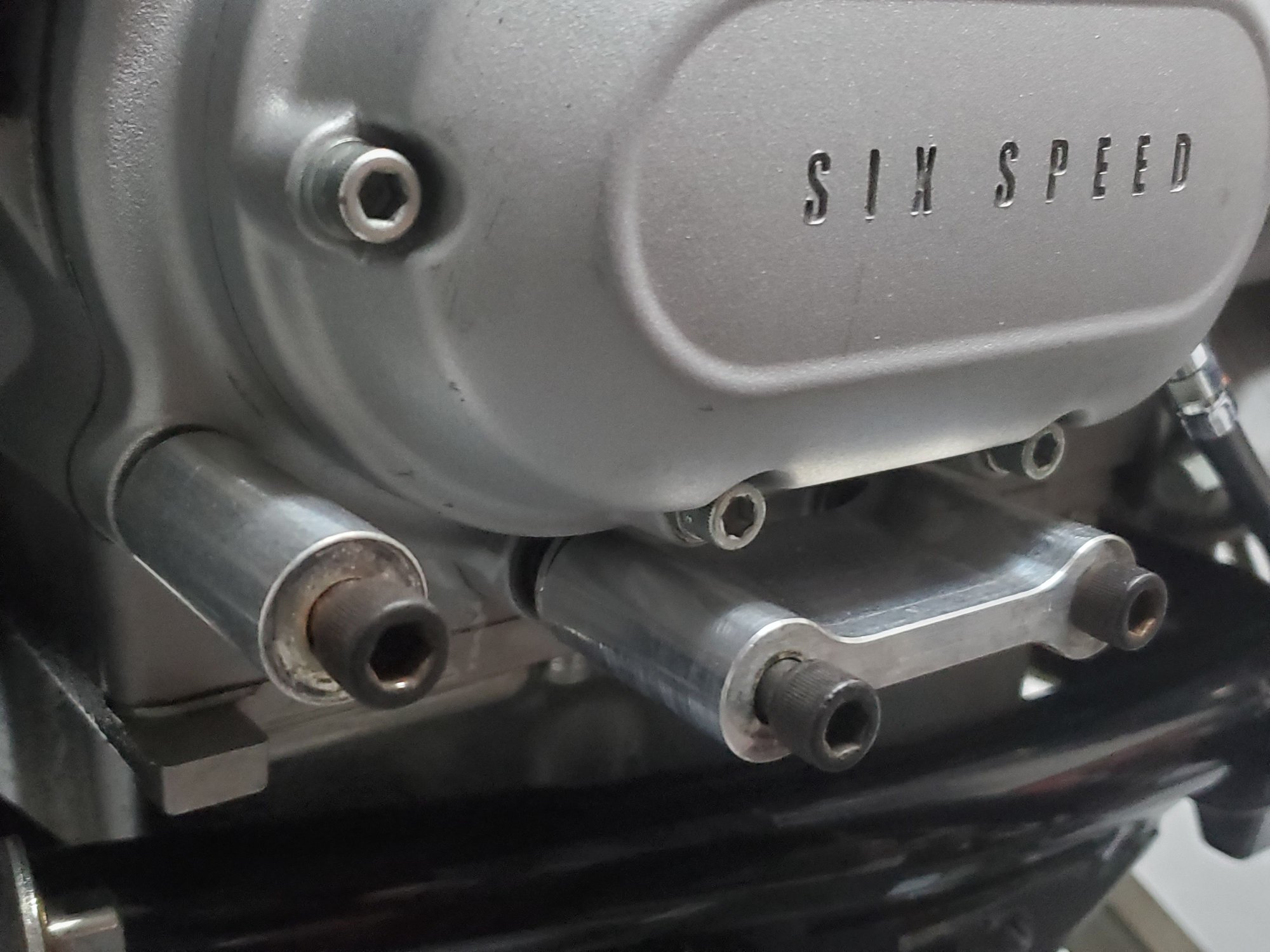

Hi Everyone,
I have a 2007 FXD. The bike came with a Rienhart "by Bub" exhaust. The mount has 2 spacers that bolt into the bottom of the trans case. There has been leaking happening at this location and I was wondering if the washer was in the wrong spot. As I got it, the washers were between the spacer and the trans case. I'm wondering if they should in fact go between the bolt and the spacer. Any help would be appreciated.

change them. I would

Use a sealer on the bolt threads and swap the washer location.
