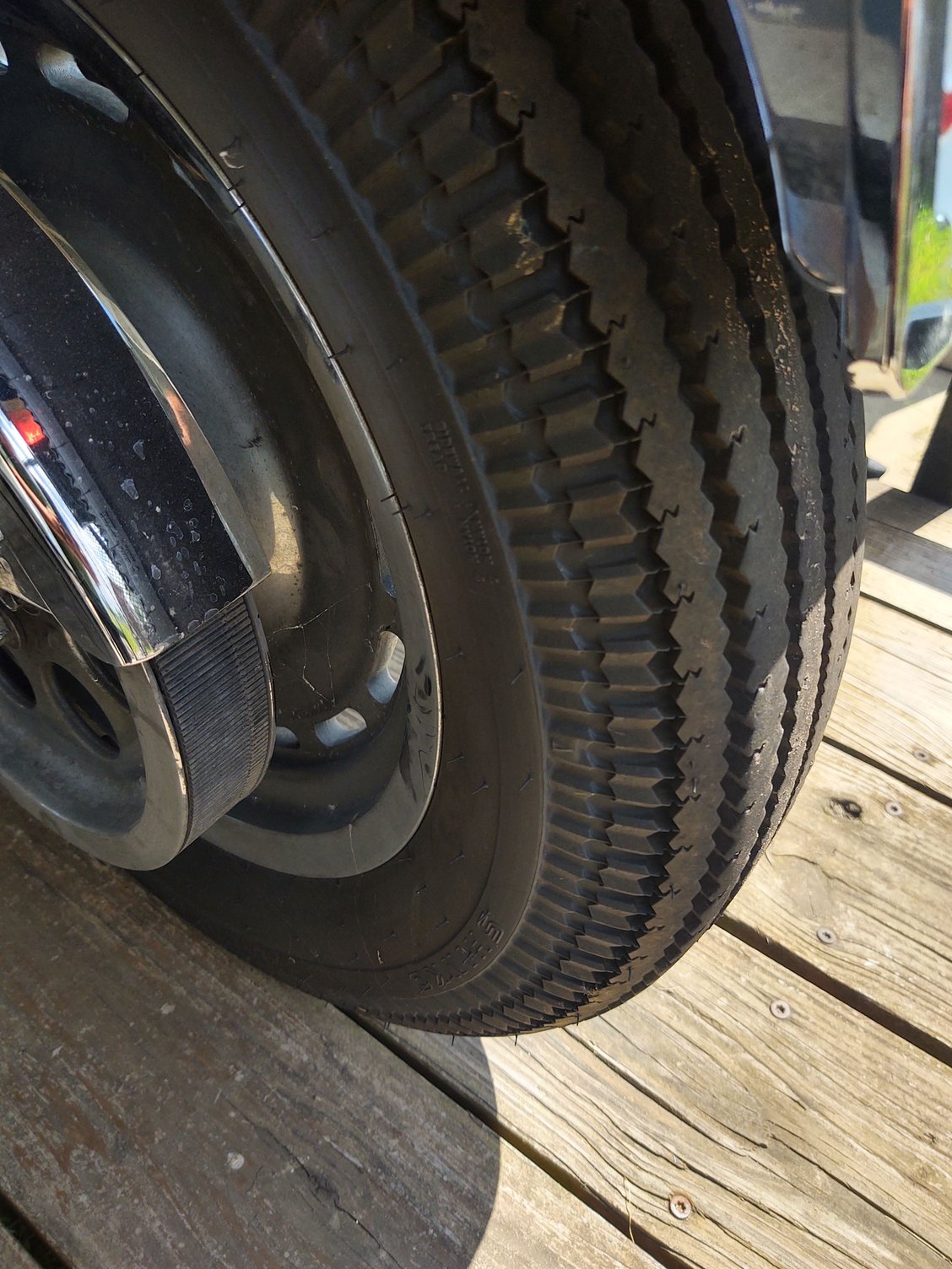

Looks like it's been sitting for a while. Couldn't hurt to check the date codes on the tires. They might be 20 years old.
Tires were just put on last year. Never been ridden since.

I swear, from that angle, that looks like a car tire on the rear.
That's what I thought when I saw the first pics. But no they're motorcycle tires.
Matched set front and rear.

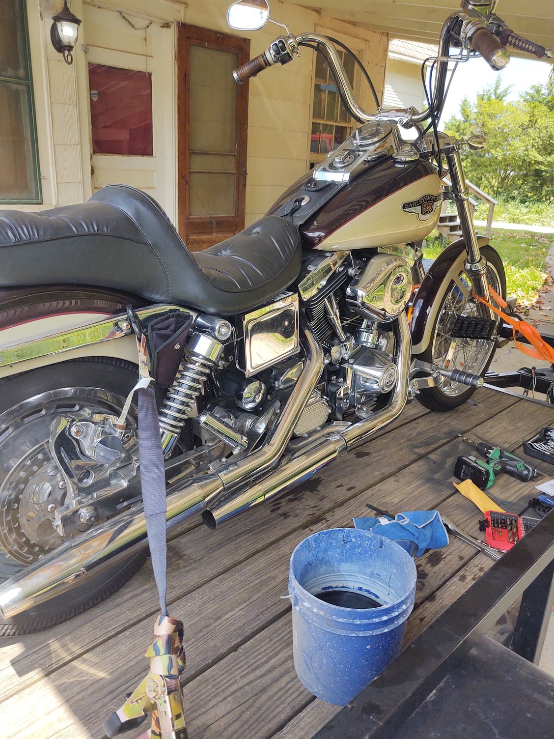

Here's a better pic. It's only got 12,000 miles on it. Just ordered $2100 worth of parts and accessories yesterday. Windshield, Engine guards Shifter/ Peg,l brake pedal Already installed. All lubes / filter, Grips / throttle lock, Head light upgrade ,Signal lights. Saddle bags H.M. ,Luggage rack And miscellaneous other maintenance stuff.

The oil pan drain was stripped. Actually the transmissionl drain.
Apparently some one used a helicoil for the repair
That's usually a one time fix and not permanent
There was basically very little thread left
So I drilled and tapped 1/64th larger and found a 5 x 20 O.S. plug.
Worked perfectly. But I ordered a new oil pan anyway for next oil change.
