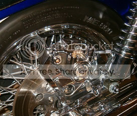

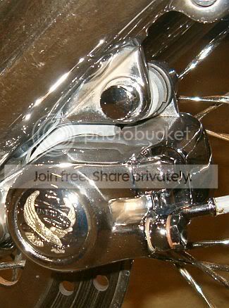

Sabaka... Love your WG. I've got a ( new to me) '96, with very low miles in imaculate condition. When I'm looking for ideas for the off-season additions I'll be doing to my bike, I look at your's!
One of the many questions I got for you is what make of brake calipers are you running, and are they two piston, or one?

Thanks! They're single piston Chrome HD calipers. They work good and look good imo
