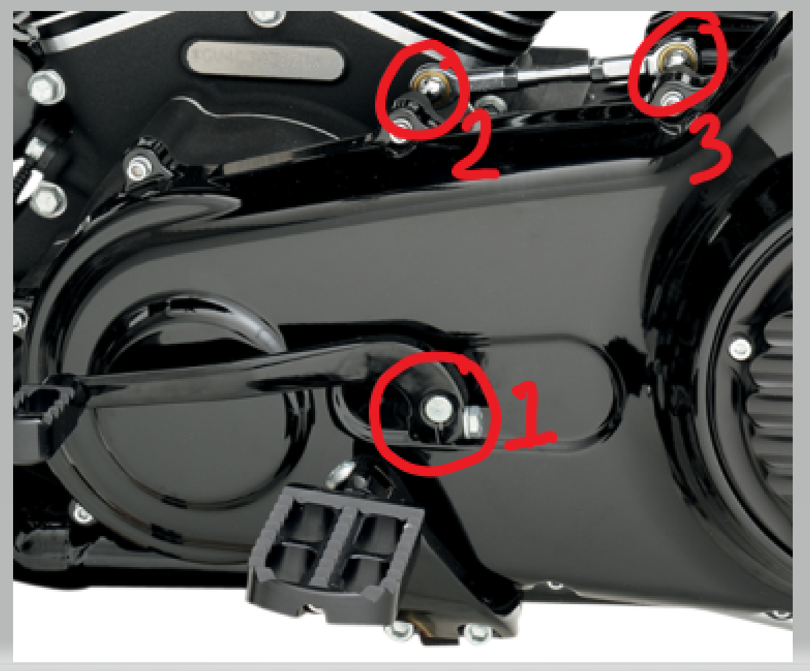

This might help.
1. is the splined shaft coming through the primary. Yours has a cap on it.
2. is the lever that is part of shaft 1.
3. is the lever that attaches to the tranny.
and you can see the shifter linkage that I sent the link for attaching 2 and 3.

Thanks very much to all so far for the responses. I am going to have to dig a bit to answer some of the questions and to learn a bit myself. I know that the lever at #3 in snake_eyes pic is there, because the linkage from the forward control connects to that one. I will have to pull the little cover on the stub coming out of the primary cover to see what's in there. If I'm reading right, it's likely that there is a splined shaft in there that has the #2 lever on it and it has just been rotated down out of the way. Sounds like that is best-case scenario, and I'd just need the shorter connecting rod to tie everything together. It doesn't look like the peg mounting brackets are interchangeable from forward to standard position so I'll need to locate a set of footpeg mounting brackets for the standard location - is that correct?
