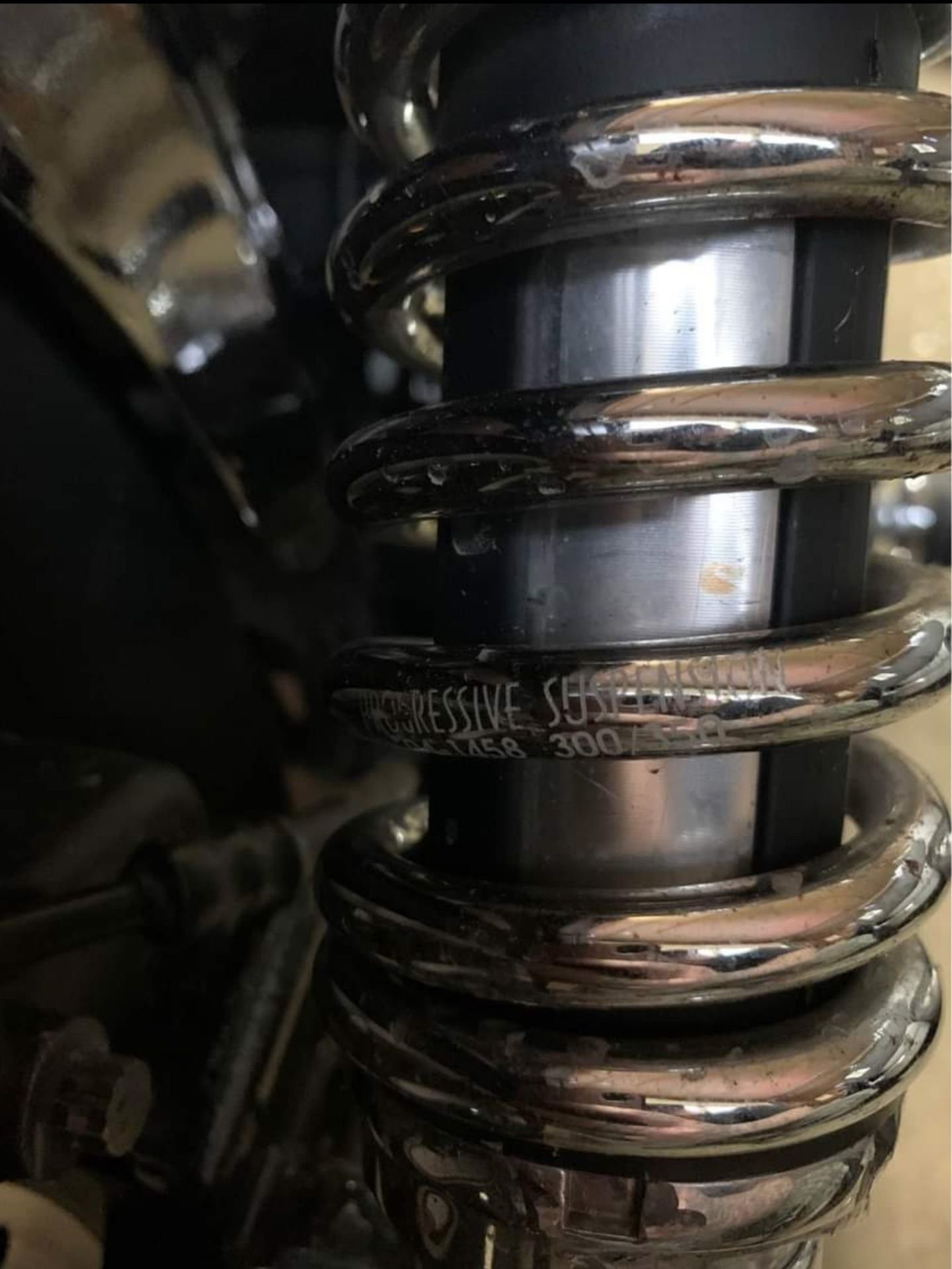

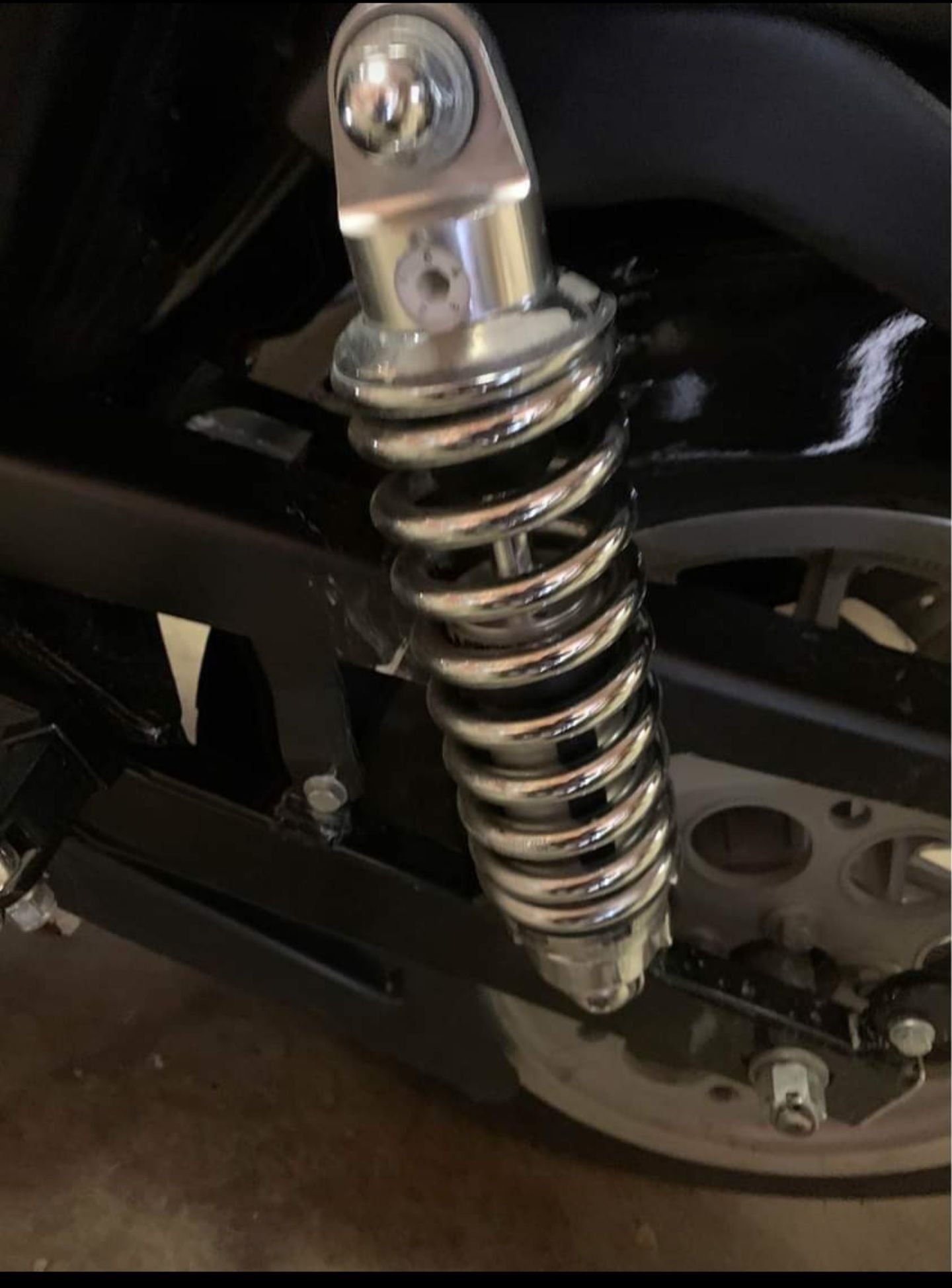

Hello. I can pick up these used shocks for a good price and I was wondering if anybody could help identify them. The progressive site doesn't show a model that looks like this. I'm wondering if it's another brand that is using the progressive springs. BTW these are currently on a 2005 FXD. Thanks!!!

May help if you can post the numbers on them here.

The guy I'm talking to and doesn't know too much about them. I'm hoping somebody can identify the brand and model by sight

Looks like one of these:
Progressive Suspension 418 Series Shock Absorbers
418-4839C 11.50 292 9.6 244 1.90 48 E/E 04-1458-30 300/350 5.36/6.25
418-4845C 11.50 292 9.85 250 1.65 42 E/E 04-1458-30 300/350 5.36/6.25

Progressive used to have a line called Active or something like that. Maybe it's from then. They seem to have quietly dropped the line.

That's it! Thanks man!

after I've researched it, I now inow that the 300/350 is the spring rate. This shock's weight capability is equivalent to a standard 11" 412 shock.
