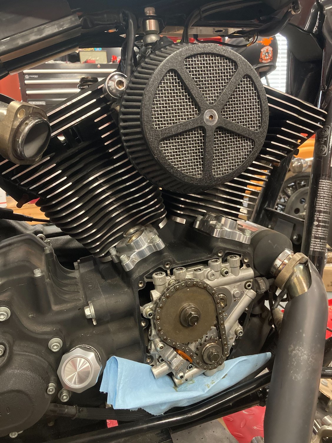

Old Jan 25, 2022 | 12:42 PM
Abandoned's Avatar
Abandoned
Joined: Feb 2012
Posts: 574
Likes: 15
From: Carolina
OK here's some pics of the tear down, more will follow when I get the cylinders back and can start getting this together.
