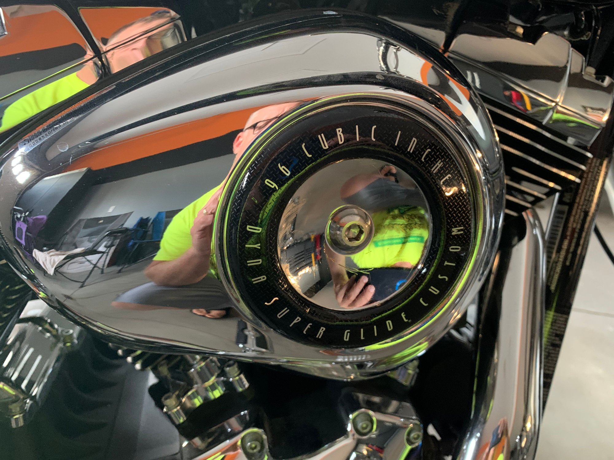

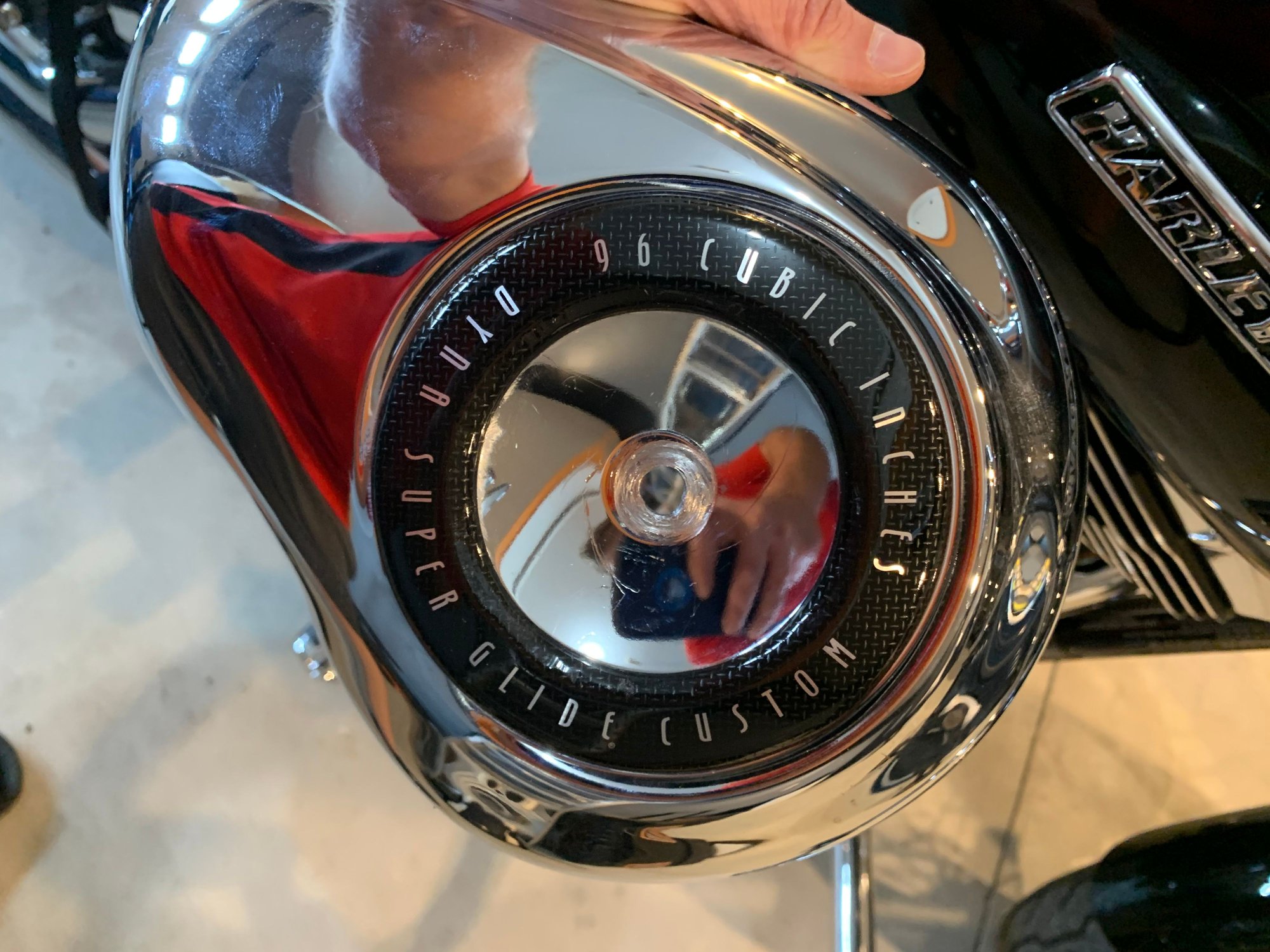

Bolt just spins. Any thoughts on how to get it off without ruining the air cleaner?

Welcome to the forum. Might want to check in 1st in the new member area...but to give my answer, I'd have a friend pull on the cover while I turned the screw. Then time for a helicoil rethread kit.

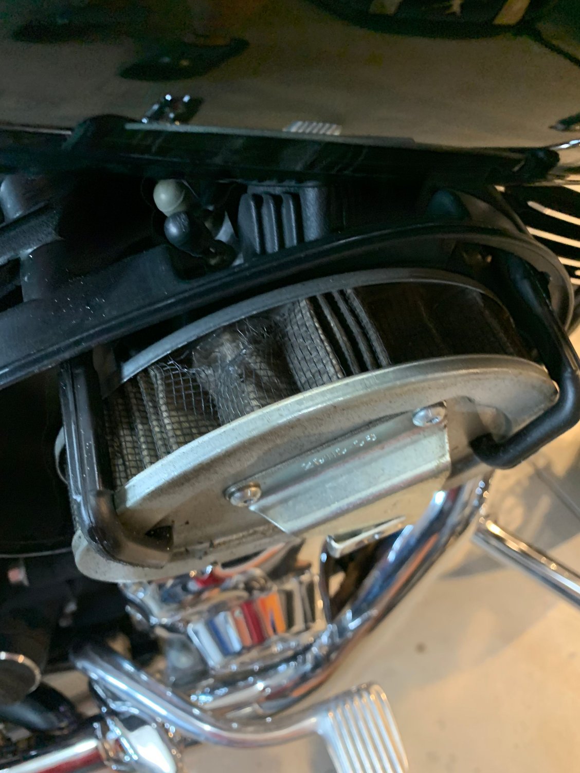

Tom there's a clip nut behind that machine screw. I would do as riffraff suggested and pull on the cover while trying to extract it and then replace both the screw and clip nut, sounds like one or both are stripped out. Could also be that on the last install you missed the clip nut altogether and it's just hanging in there somehow. Keep us posted.

I am sorry if I didn’t follow the etiquette and for the late post but I finally got around to wrenching on my bike again. I had my son use the impact while I pulled on the cover after getting a screwdriver behind the cover then spinning it to where I could get a grip. I pulled with both hands and finally it busted loose. I am going to get a new speed clip and bolt and replace the air filter. I have to try to clean up a few small scratches on the cover too. Thanks for your help.
