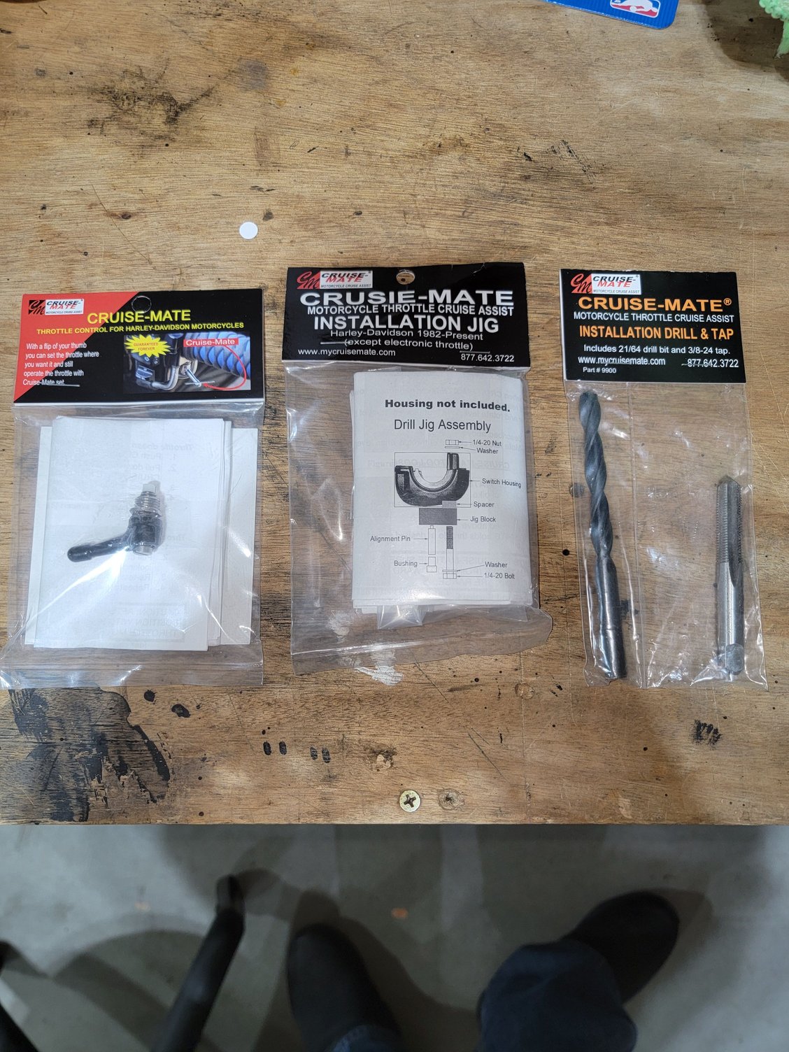

I just ordered this Motorcycle cruise control (mycruisemate.com) based on another members recommendation. Probably install it today and I am super psyched! I had given up on cruise for my '17 FXDB. Everything either looked like *** or looked stupid. This thing is totally hidden!

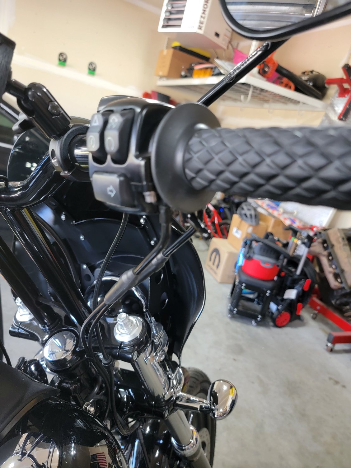

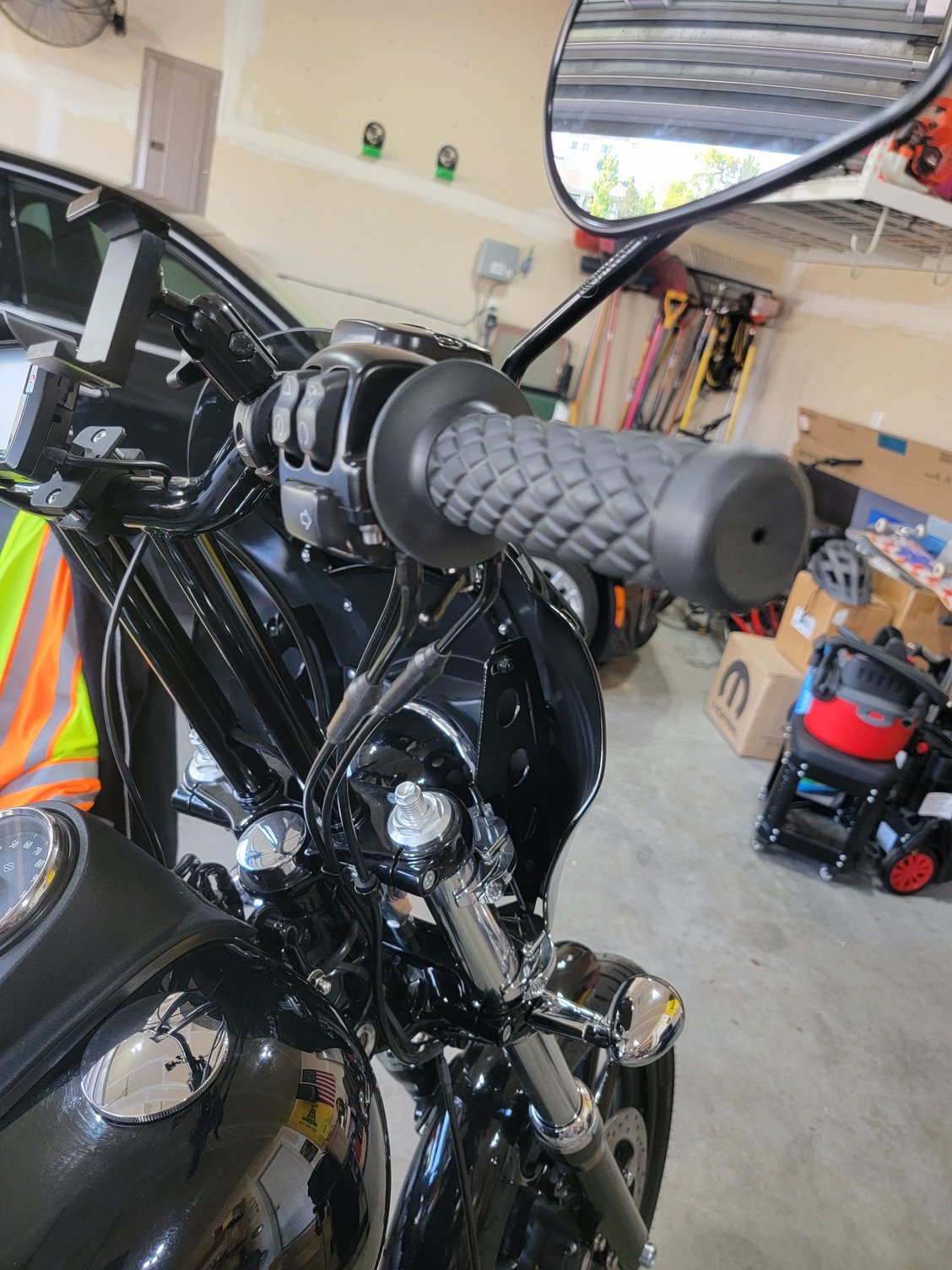

Well the install was easy, getting the lever dialed n took longer, lol. Check out the pics, can you see it? top is off, bottom is on. Haven't ridden yet but garage test is 100%. I adjusted it to move a little less than a 1/4 turn to engage and it flicks off completly.
