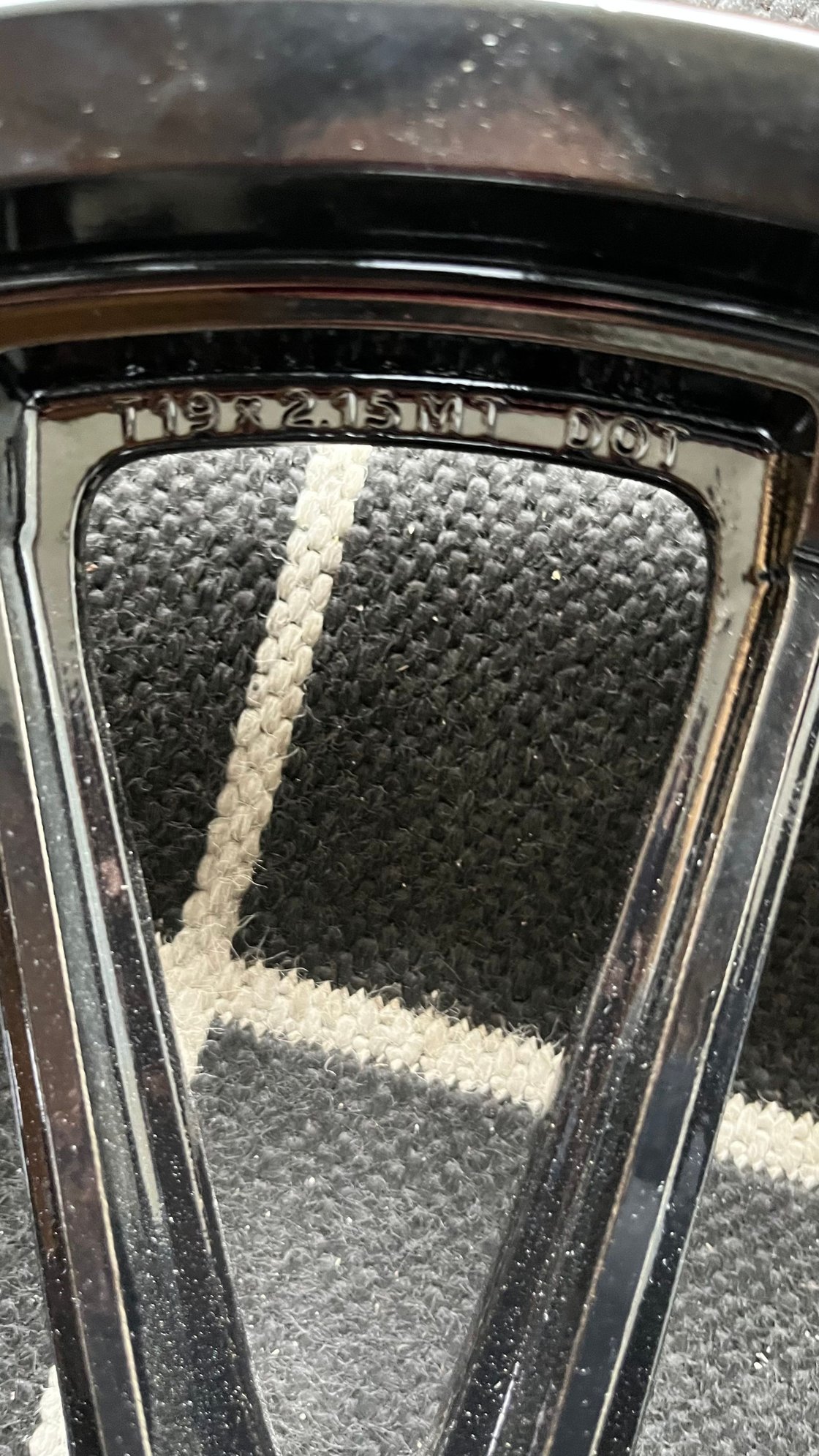

Hi,
Have dyna fxdi 2005. Currently sitting on spoke wheels. Bought mag wheels for both rear and front. Know that my spoke wheels run a tubed tire. Question is, Are the mag wheels (tubeless) gonna run the same tire size as the spoke wheels?
Can see that stock front wheel has T19x250 and the new mag wheel is stamped with T19x2.15. Are the booth compatible with same tire size?
Any help would be appriciated.
T19x2.15

it appears to be 3/8" of an inch difference.Shouldn't make a differance

Technically the correct size should be 90/90-19 or MJ90-19 since its a 2.15" MT wheel. But 100/90-19 or MM90-19 will work and is a much more common size.
but with the 2.15" wide wheel I wouldn't try to run a 110 or 120 wide front tire that some guys do on the newer 19x 2.5" front wheels.

So the stock 100/90-19 tire should fit the new mag with 19x2.15?
Old Jul 12, 2023 | 11:45 AM
2500hdon37s's Avatar
2500hdon37s
Joined: May 2014
Posts: 3,155
Likes: 1,728
From: Mid-MO
Yes

Besides the already correctly stated "Yes, that tire will fit", and just for some additional info ... that 13-spoke "Mag" never came from the factory with anything but a 100/90-19 tire (the tire in question)

And you don't need the tube.
Better for roadside tire repair.
