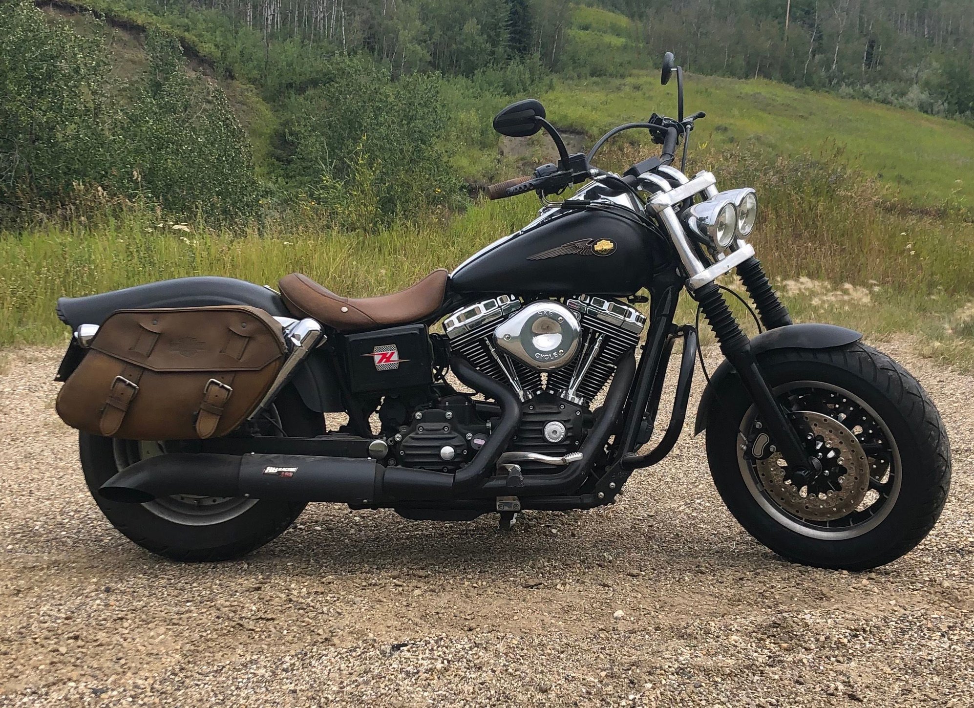

Originally Posted by SwedishMeatball
They are the same kind of forks, but the slim has covers on the triple trees and the upper part of the sliders.
If you want the full covers you can change the whole front end to one from the slim, the triple trees have mounting pints for the covers. It should be a direct swap, both bikes have 1" stem and zero rake in the trees as far as I know. There might be a difference in the steering stops so there might be some modification involved.
You could also just use the lower covers without the part covering the trees, that's a quite popular mod in the jap style scene. I had thet on my previous bike, with the covers attached to the fork tubes using 3D printed hidden clamps.
Not too far from a direct swap, but grinding is required. Not too big of a deal, but it would take lots of work to go back to a standard Dyna front end if the OP decides that he doesn't like the FL front end.
SwedishMeatball, I really like your previous bike, I'm looking to do something very similar for my next project. I'm hoping to start this coming summer.

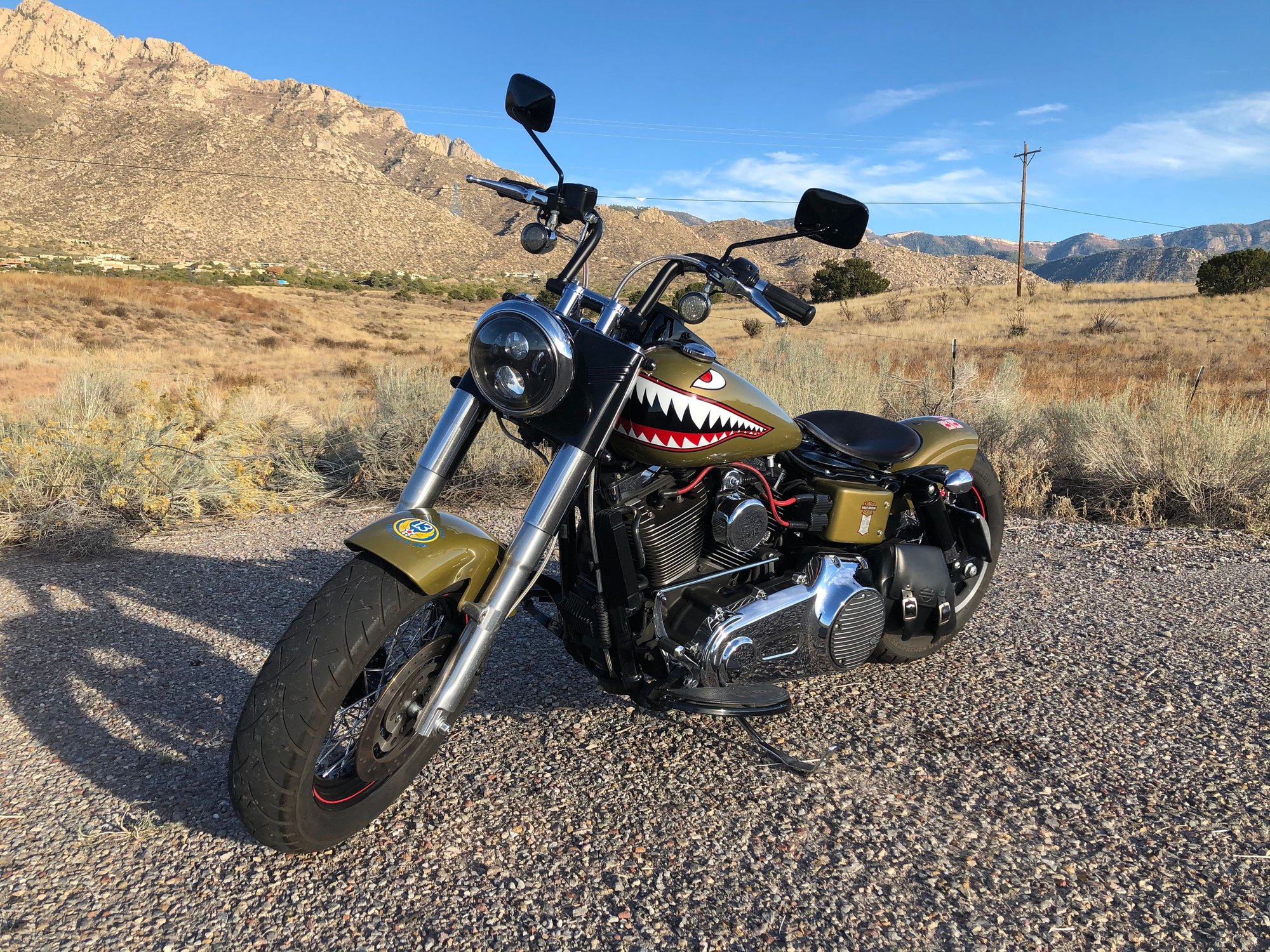

Also a couple of pictures of my bike. I did the swap a few years back. Good luck with whatever you decide.

Did you intentionally align the bike with the fence brace rail?
I did not take this photo actually, but Im sure its pure coincidence.

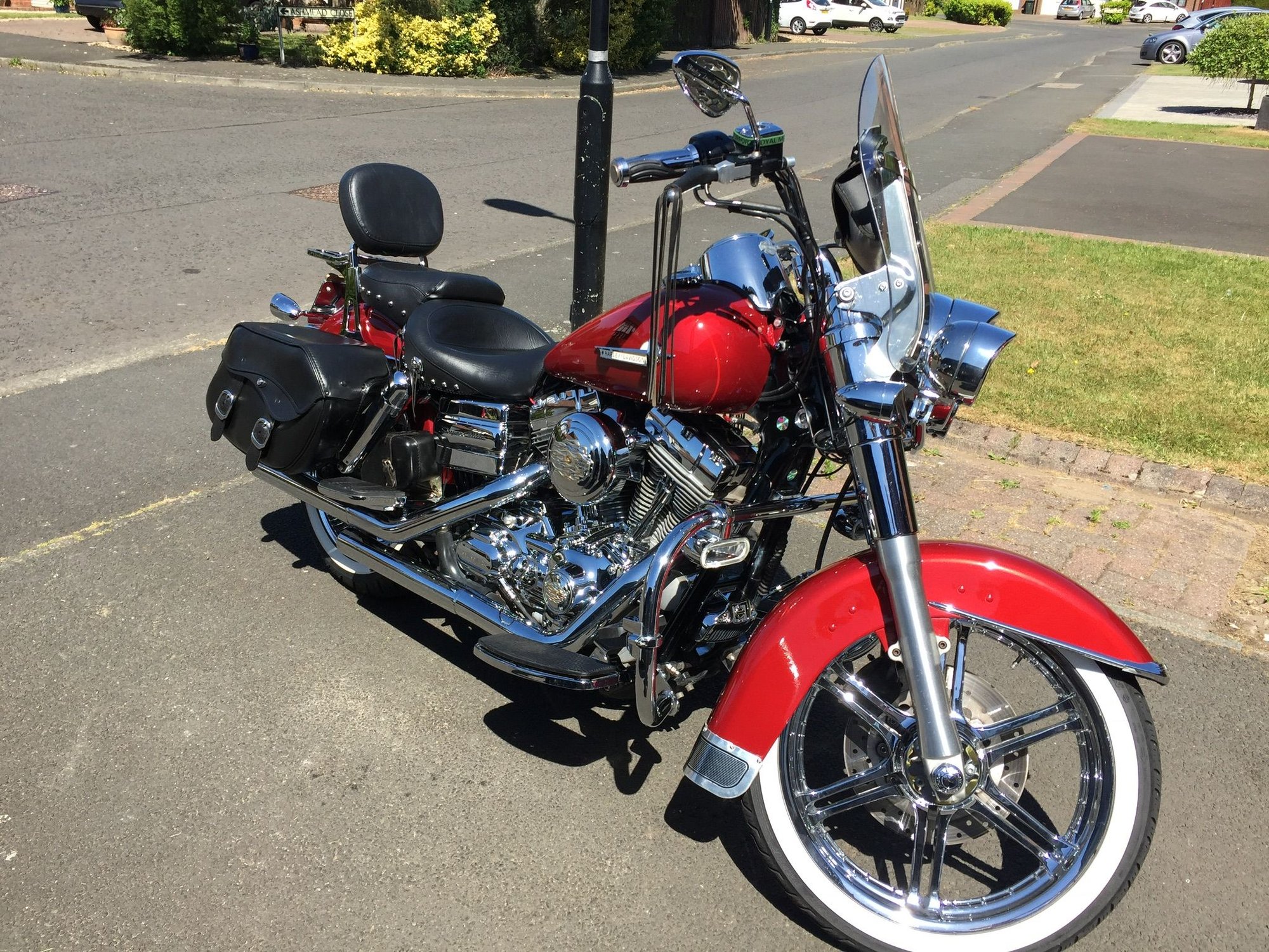

Default Fld switchback front end on a 07 fxdc
Quite happy as to how this is going
