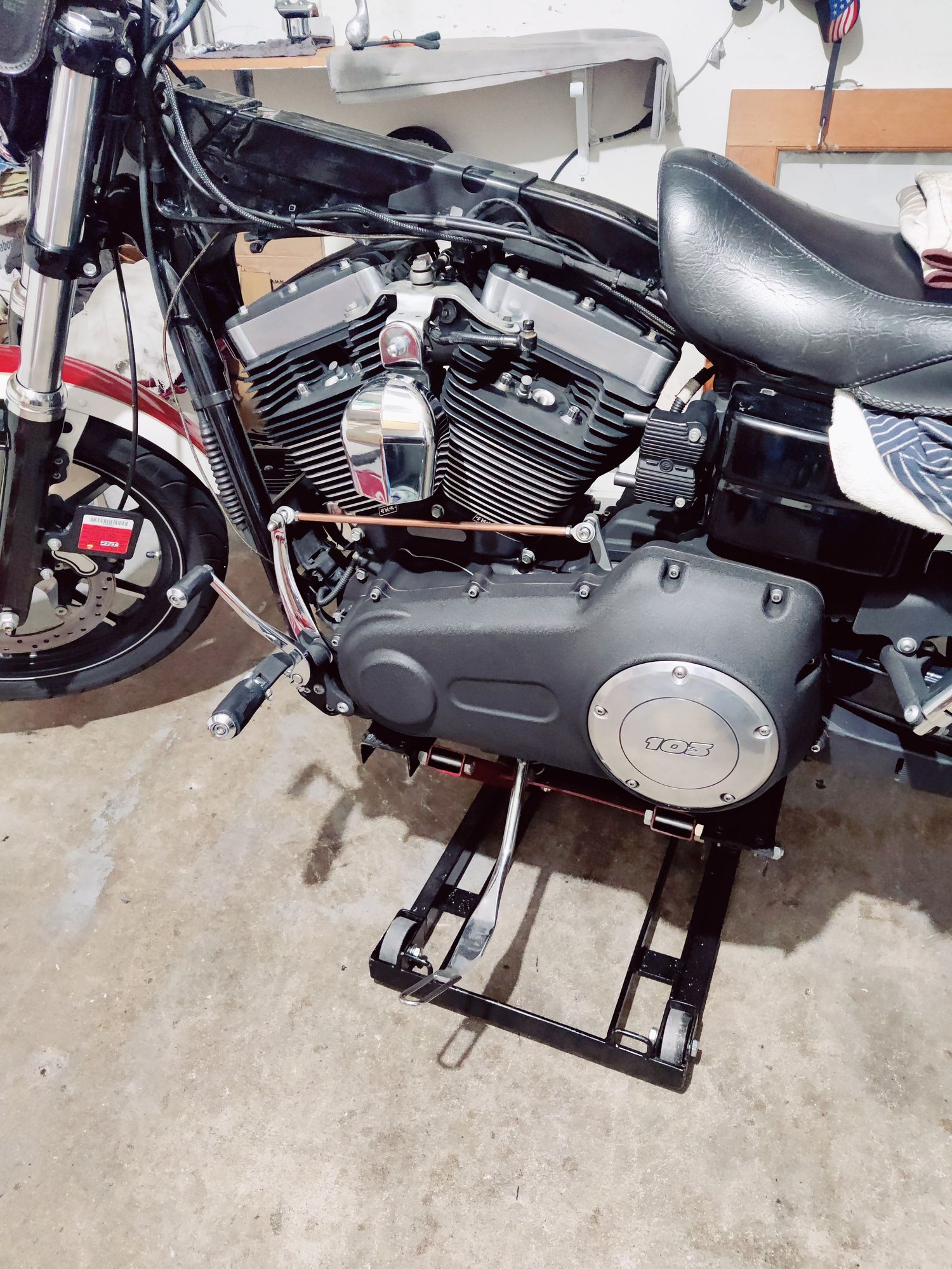

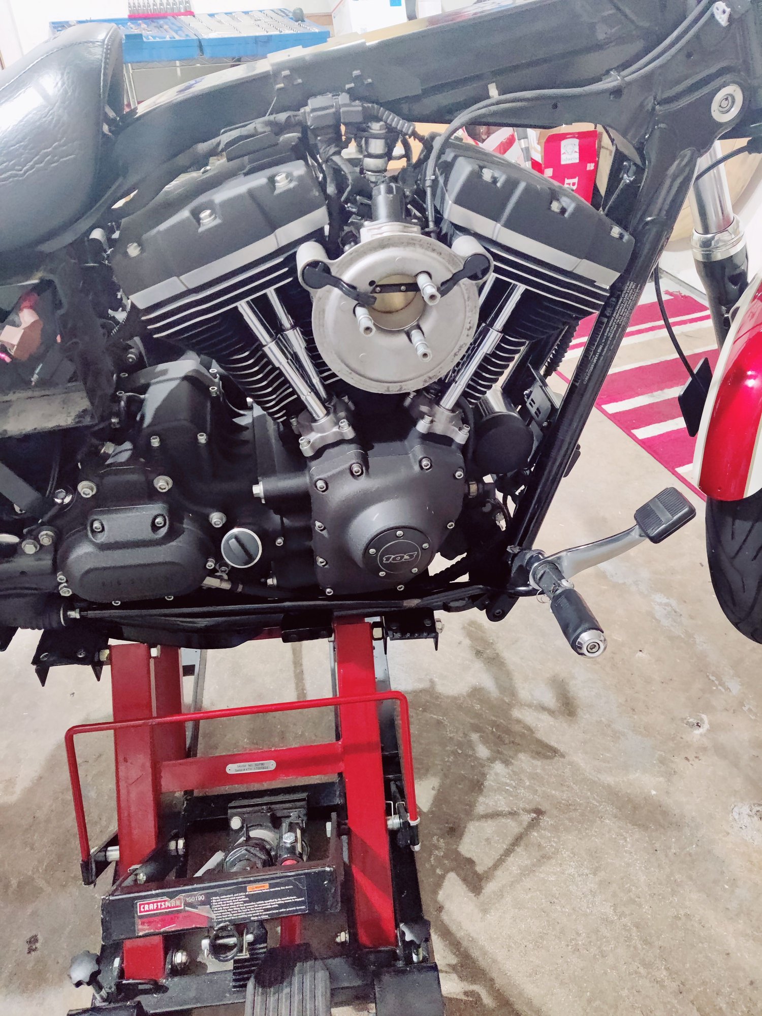

A little update, a little over a week ago I got my heads back and as I was putting everything together after removing cylinders and pistons to clean everything up so I could clay valve to Pistons and replace the cylinder base O-rings.. I found the intake rocker geometry was way off..I took pictures and sent them to the shop to discuss a plan of action or should I say a repair..
So the heads had to go back to have shorter intake valves installed and reset spring pressure on the seat.. I now have 170 psi valve on the seat.. And today I got the heads back and started to reassemble everything and the geometry is a lot better..
So I was able to get the heads on, rockers all assembled and set pushrod preload to .135".. Because the heads were shaved .080" I had to change the width of the new 1.800" intake from HPI.. I also replaced the rear socket cap screws on the intake flanges with a regular hex bolt.. it can be a real pita to tighten the OEM screws with an Allen wrench.. A 1/2" wrench is a lot easier..
If everything goes good I should have it running tomorrow..
