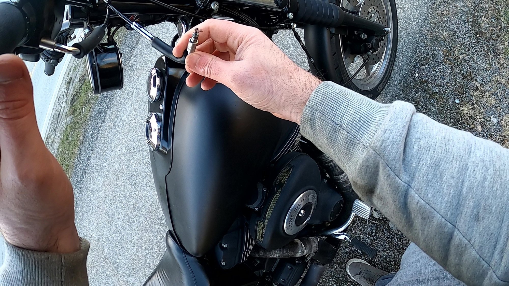

It broke at the throttle handle (see picture). Is this an easy fix or do I have the change the whole cable?

Looks like the ferrule at the end of the cable broke off, if yes you need to replace the entire cable. Is it the throttle cable or the Nanny State return cable? You can live without the return cable. The closest one to you when seated on the bike is your throttle cable, the one to the front of the bike is the return cable. Good luck.
It is the one to the front of the bike. But I couldn't throttle, the throttle handle was just loose. So I had to get the biked towed home.

Probably best to replace as stated above and inspect the other cable end for wear/abrasion. Cables are about $30.00 US. each.

As stated, if one broke it's time to replace them both.
You'll be in there anyway and you'll know you're dealing with new cables.
The labors pretty much the same, just a second cable to buy.

1. Risers on the handlebars could make the cables a touch too short when turning fork lock to fork lock.
2. May want to check to see if there is any binding of the cables when the front fork is turned.
3. If any binding or the cables seem tight, it may be worthwhile to get extended cables.
4. If no tightness or binding go with OEM.

On my FLHTC the front cable opens the throttle and the one on the back(close to you ) is the return cable. Which way do you turn your twist grip?
