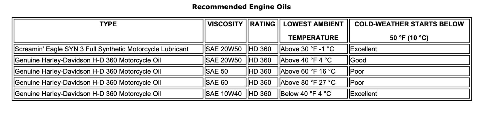

You also don't say how cold the temps are when you are starting the bike. Make sure your oil weight is suitable for the cold temps you are riding in...
For example, a straight 50wt would suck at 30° temps..
If you are riding (starting) in low 40° and lower, might think about using a 10W40 weight oil..
Harley oil weight recommendations from 2016 Owner's Manual. Ignore their shameless plug for HD labelled oils any quality oil will do. Notice the recommended temp range for HD360 (dino oil) and temp range for Syn3 (synthetic oil) differences. Also note they consder a cold weather start below 50°..
