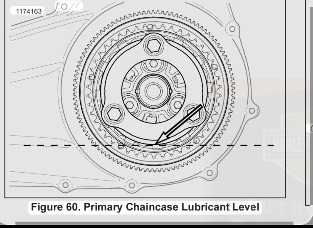

Another simple process being made into rocket science.
Set the level at the outside diameter of the clutch shell, on any OEM clutch, mid 1984 or later.

Originally Posted by Notgrownup
Ounces make a huge difference.
Right! Drain it all out, then add the correct amount. Done!
The discussion topic is 2007 FXDL. My FSM says "add 32 ounces". No mention of clutches or levels.

[QUOTE=Jackie Paper;22235557]
love your answers. Is that the lockup clutch option on a CVO or just the latest version of a Harley with a hydraulic clutch in post 5? I wasn't sure.
One can look carefully and see the red line does fall along the rear sprocket area but towards the front gives the impression the oil level would be very low.
I would definitely uses the amount level on that one.
Harley example for level with the hydraulic clutch actuated by a slave cylinder
That's what the clutch looks like in the wife's '22 FXBBS

Let the primary drain for 5 or 10 minutes to get all of the old fluid out. Replace the drain plug and dump a quart of fluid back in it. Even if it's a little below the bottom of the diaphragm spring, there's still plenty of fluid in there and it will get picked up and splashed around when the clutch spins.
