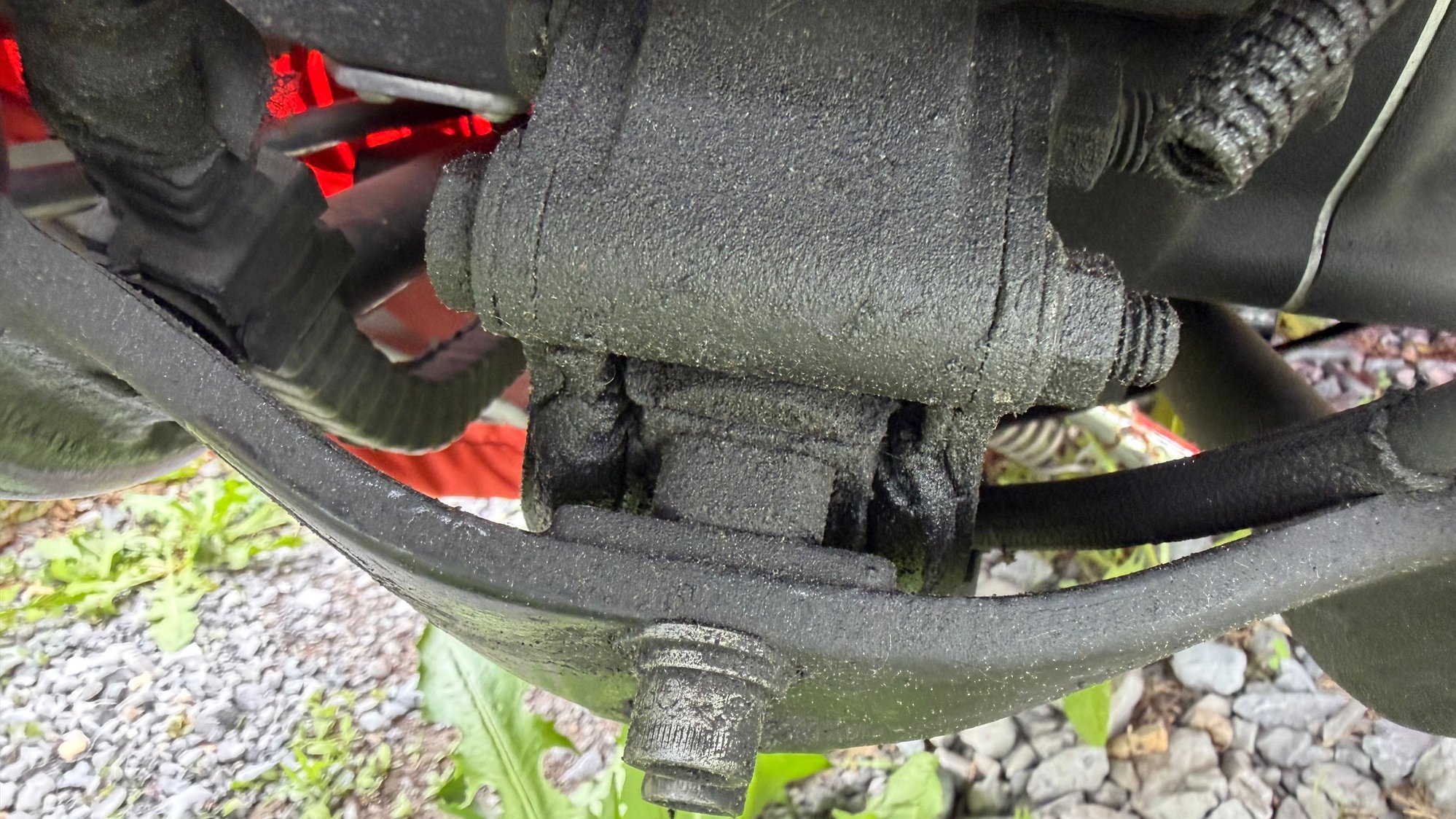

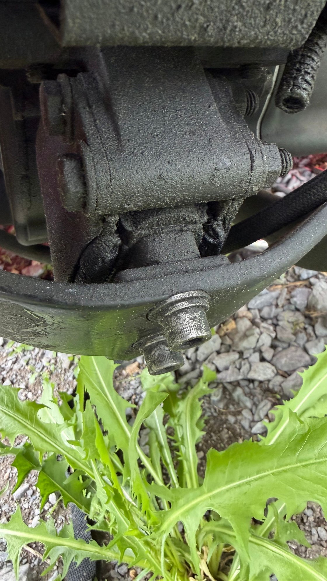

I don’t know if you can tell if the front mount is bad or not from the pics but they look good to me but I’m no expert lol.
Pretty sure the circled area is what @John CC is talking about, is there a gap there? Either way man, I have SEVERE OCD and I could not ride that bike like that, give it some love and clean it up. You take good care of it, it'll take good care of you!

I’ll go take a better look at it I wasn’t sure what he meant by the domed area. I’ll clean it up too lol.

Well there’s definitely a gap between the rubber and the metal so I guess it’s okay. What do you think?
