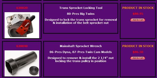

Originally Posted by mikeurig
Others say we need a 2-1/4 inch socket to remove the pulley. I like to get this clarified before I go and by a socket.
Depends on the year of your bike. If you search the threads then you'll find where the source for the socket has been posted a few times. On that website they tell you what size socket you need for your year of bike.
This is it:
http://www.georges-garage.com/trans_06_up.htm

Ah... 2.25"... My mistake. I'm sure I posted the right size at some time in the past when I'd first finished the mod but my memory sucks. But it does depend on the year of your bike. The older bikes have smaller nuts. heh heh Yeah, I said it.

Just to add the info for future reference...this is a screen shot from georges-garage.com:
