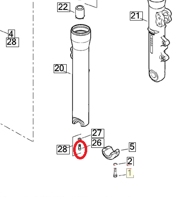

New addition:
2017 FXDB fork tube (l&r) damper (socket head) screw p/n 46614-06 ....................... 12mm 6-point socket head bit
contribution of multihdrdr

To be clear ... in above Post# 47, it is a 14mm bolt (shcs) needing a 12mm Hex Bit
Likewise the above bolt in Post# 40 is a 8mm bolt (shcs) needing a 6mm (M6) Hex Bit ... NOT M8
Working on my FXD '03 replacing the fork tube seals I noticed the fork damper screw needs an extended M8 hex socket wrench:
Note by FXD2003Rider:
Info provided by multihdrdr processed!
Wrench/bit sizes adjusted!
Thanks for the heads-up multihdrdr!
