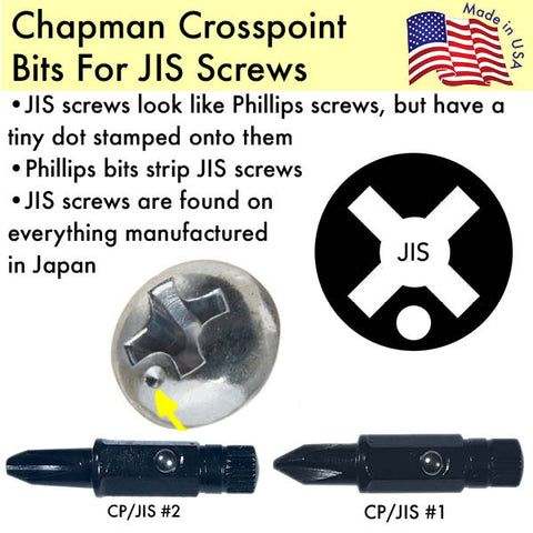

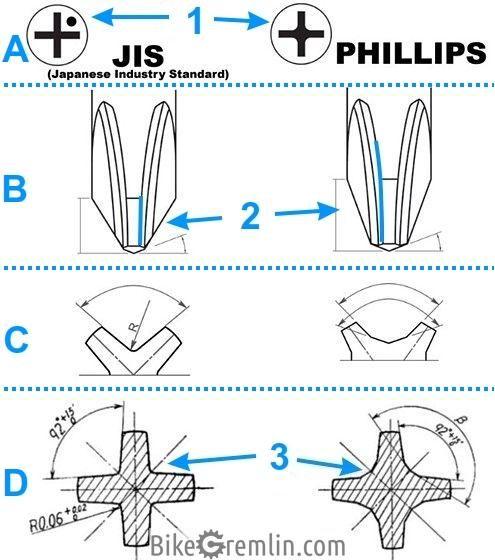

Another thing to be aware of is that the fork drain screws and carb screws are very likely JIS (Japanese Industry Standard) and it is very easy to strip the heads if you use a Phillips screwdriver.
In a pinch you grind down a Phillips tip and it will fit much better but a set of JIS drivers or is not expensive. FWIW JIS drivers usually work OK on Phillips screws. JIS screws sometimes have a dot on the head.

A JIS screwdriver will often salvage a buggered up Phillips screw head, too. There's a company called Vessel that also makes good JIS tools.
