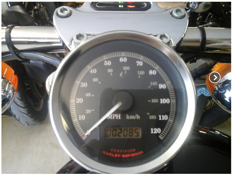

Originally Posted by Stag556
I know these aren't mini-apes but never hurts to give you options to see what you like. This was my old 2009 Super Glide that I put drag bars on.
what speedo is this. I hate my black stock speedo on my 06 FXDI that stick up and out over the handle bars. I like the chromed look and how this one is basically reversed from the original.
Looks like a XL 1200 Sportster odometer set-up to me...
