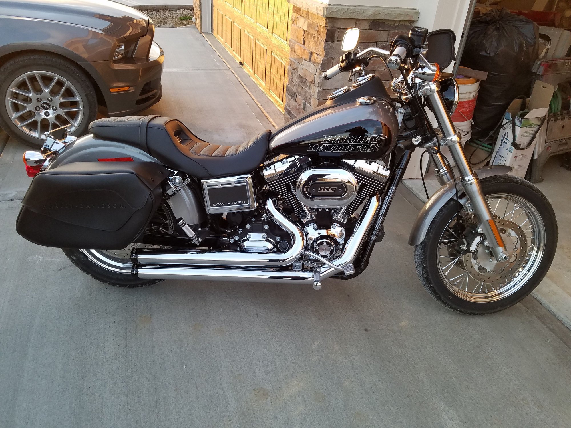

I put a set on my 2016 Lowrider, 1" drop for under $40 bucks, no rubbing so far. bought them off ebay and did nothing to the front, 90mph abd all still felt good.
Fit fine with my HD bags
