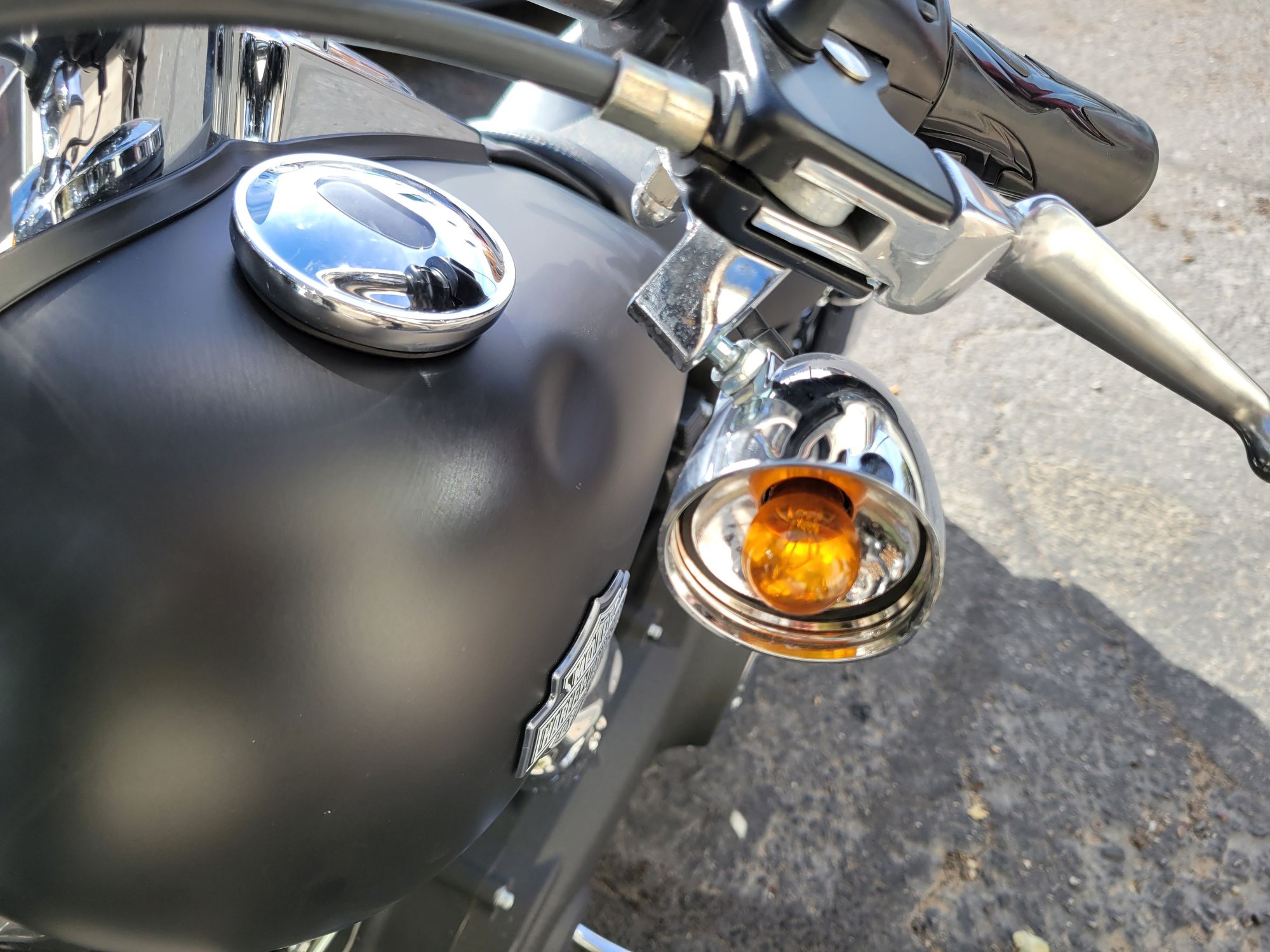

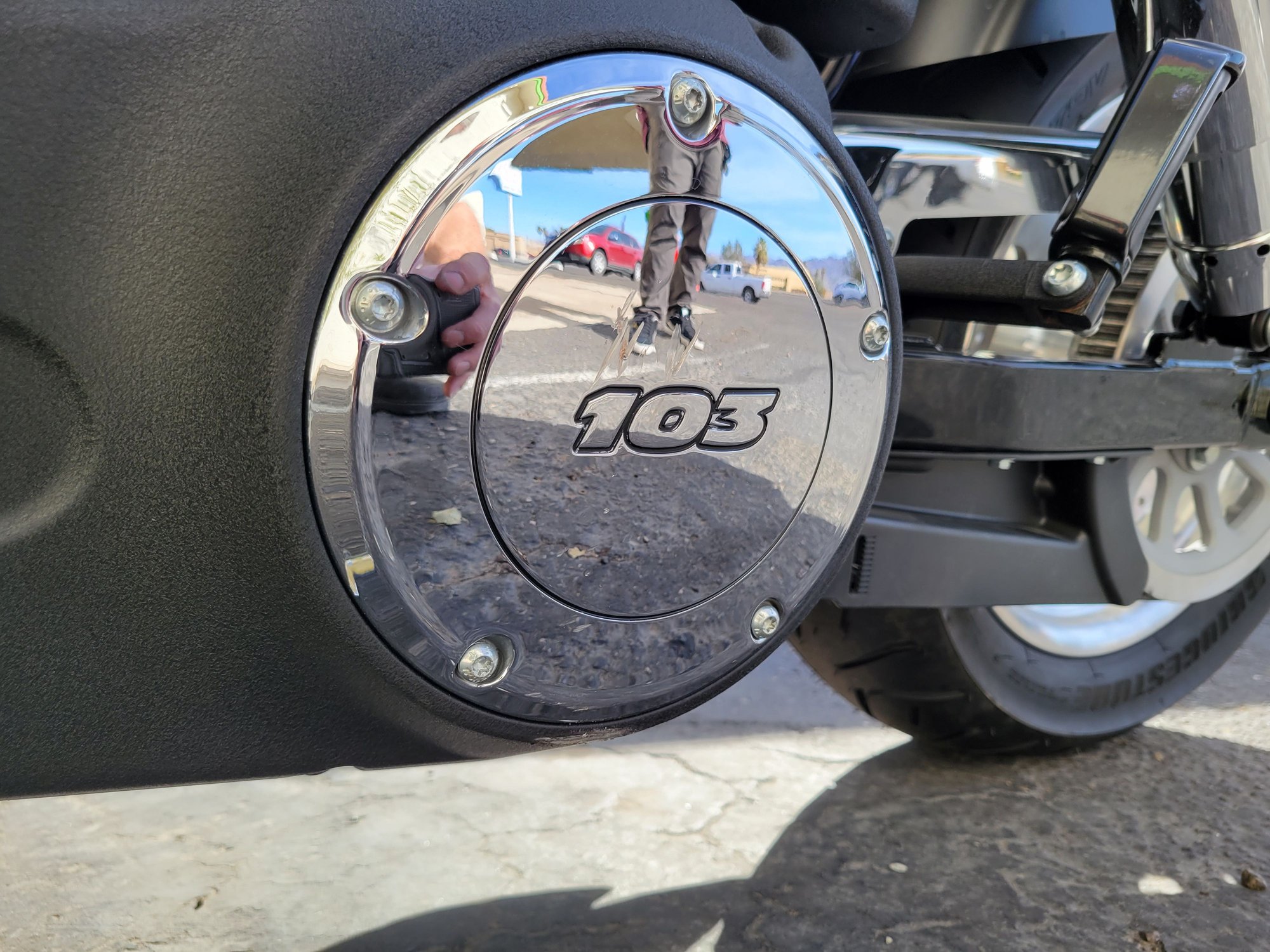

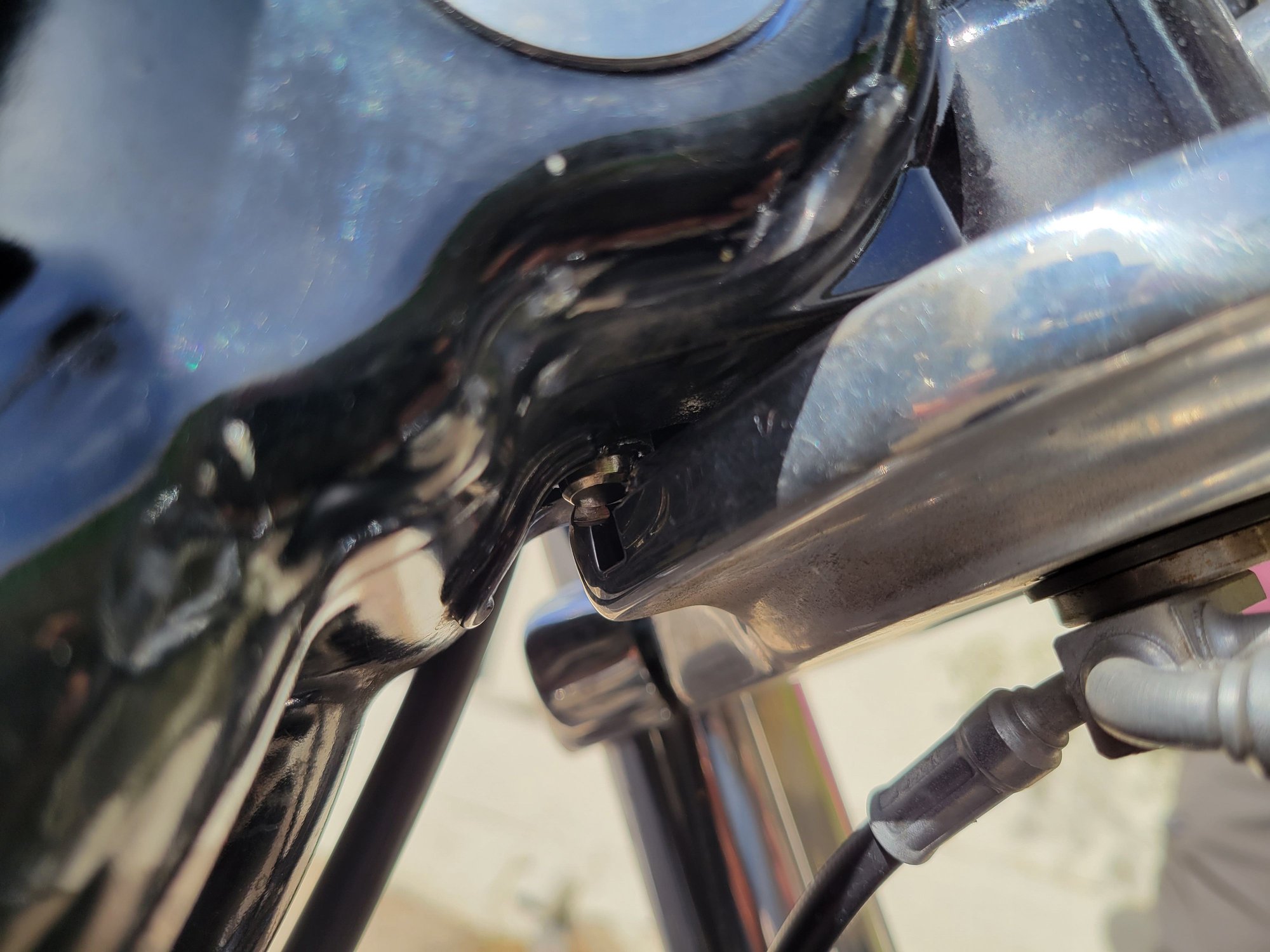

Partially engaged fork lock while riding. I had to lay it down. Yes, it can engage while riding. I hope HD will take care of this for me.
Weird
