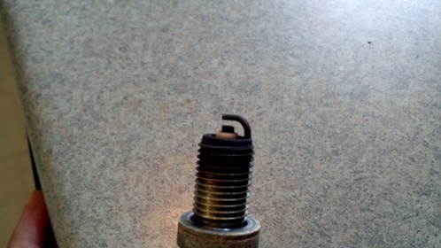

Originally Posted by grf000
Mine does not do it. Going from there, first time you hit starter and not talking about what you describe as cranking and cranking, be sure you stay on it first time. I know there is a word for it me, if I get it in my head I am going to hurt starter if I hold it in and get off just an instant too soon before other cylinder gets going will not catch and dies. The second crank get another spray and you have a little too rich mixture. Next time it does it on the second crank, open throttle 1/64" turn before hitting starter. If that helps, you have a rich problem at start up. Could be an injector leaking a few drips. You say its not but could be all the after marker add on's pig tailed in and no exhaust back pressure affecting air swirl in engine. Be interesting to pull a plug right after a hot shut down to see if it's dry. Probably not too good on threads. If I tried that I would be sure to apply some anti seize the day before to the plugs.
Pic of the plug after a hot shutdown

Plug looks dry. IS it? But appears a little rich for an air cooled motor. How many miles on your plugs. May want to try that. Here's mine at 10K, fine but got in a lot of salt on a road trip and they were all rusty. Notice slight difference between front and back. Need to try this again after hot shut down and when it is hesitant to start after some cranking. I would think if it were too much fuel you would see a wet plug. If its dry then we need to figure why it not getting fuel. PS we are talking about the 2011 FI Harley?
