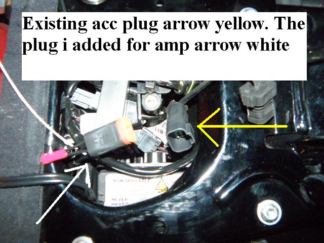

Originally Posted by Drdriller
Good advice, I just have to find the accessory fuse. Anyone have a picture or explanation for a dummy like me?
You say accessory fuse. Well look in your fuse box and you will see "acc fuse". As for the plug that goes to it, well here I attatched pics for that.
Accessory plug is under your seat. Did this last year. Bought a plug that fits and cut the end to atttatch to my accessory.
Attached Thumbnails Help with gps install-p3160095-1.jpg   Help with gps install-p3160097-1.jpg
