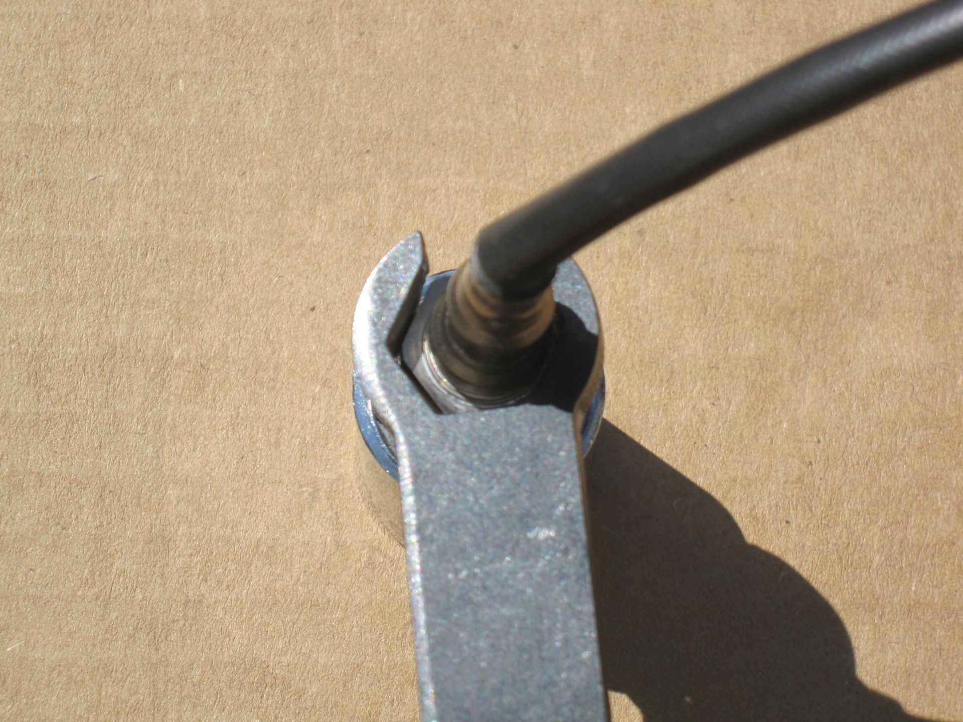

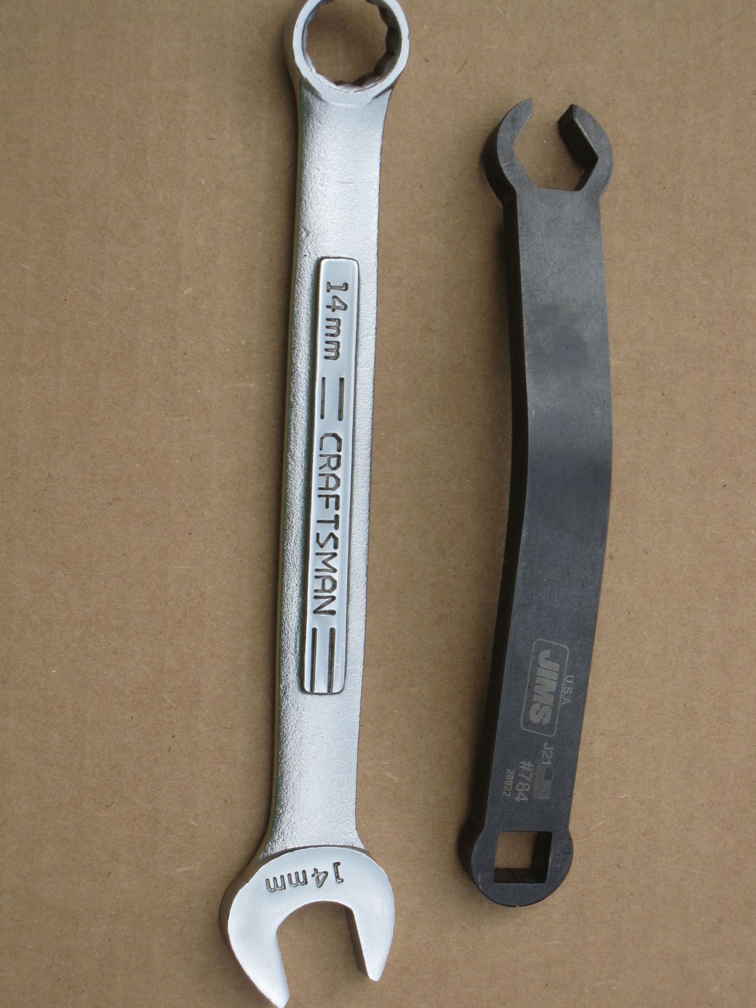

@snake_eyes Did this Jims #784 tool actually fit the O2 sensor?

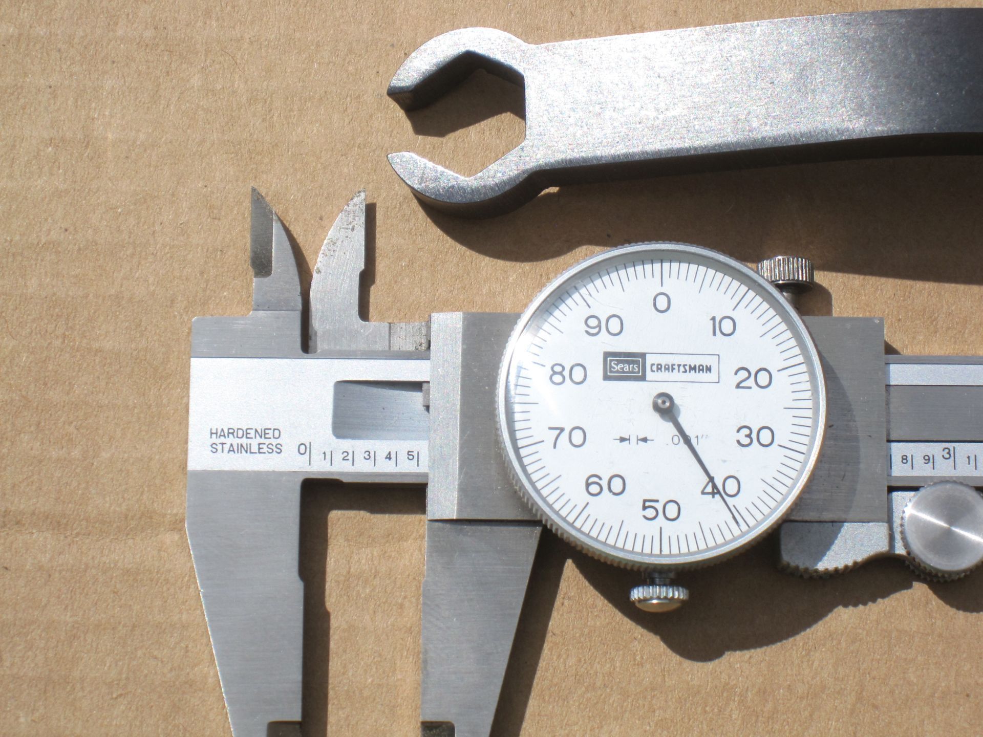

I purchased one, and it doesn't seem to fit. Date code on the tool is J21 (October 2021). I called Jims to complain, sent the tool back, and they sent me another tool. Same problem. My 14mm craftsman wrench fits the O2 sensor perfectly. Called again to complain, and it seems as though they don't believe me. I've asked them to verify the wrench fits a HD O2 sensor and they claim it does. I've attached a couple of pictures. I've measured the wrench openings and only get 0.541".
Yeah it does and it's worked, but it is a tad loose
