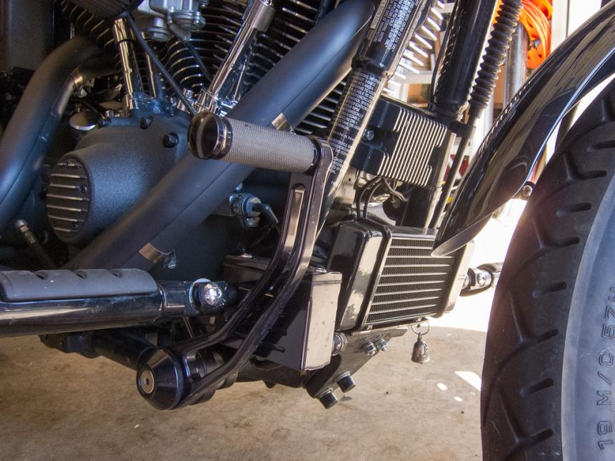

So you don't want an oil cooler
I went that route over the spoiler and mounted it to the true track

Originally Posted by parts eeter
Post some pics!!!
Your wish is my command
I used a post here where the OP did the same thing with the oil cooler. I wanted a 10 row because well a 120R... Its mounted with 2 through holes drilled in the front bracket and 4-20 bolts. The original post used tapped non-through holes. I decided the leverage on the bracket was a bit much for that so I used through holes. It doesn't vibrate while running. Sturdy and the engine runs much cooler in high temps and traffic.
Sorry - no help on the true track install, I had the shop do it. Only took them about a hour though. Dyna's are a bit rougher that touring installs I hear. Typically a shop will not do dyna's while you wait like touring frames.

I'm going tog et an oil cooler that mounts on the down tubes. I am not sure what kind of chin fairing I have as it came ont eh bike when I got it. If I get a chance I will get the wheel on and take this thing home for the weekend. I'll get a few pics without the fairing. I think it looks pretty cool.
But I am sure I'll miss the wind protection at 5am. LOL. Painted picked up teh fairing today so I should avhe it back next week something.
Photorider, your setup looks pretty cool with the oil cooler on the bottom.
Yes, I had issues finding a 10 row that would work and didn't want a chin fairing. The touring down tube 10 row will work with the mounts for the smaller one I heard. I need to get stainless steel lines - need to find black one (why I didn't go that route initially).
My Indy installed the TT and also said that the rear was a pain in the a$$, I love the oil cooler mounting, mine is kind of rigged right now just have not had the time to correct it.
