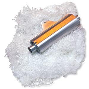

Izzy, I used the Moose packing on mine.
As you know, I haven't been able to fire it up yet to compare, but you can adjust the amount of sound dampening by how much packing you use. I bought the 250 gram bag and have PLENTY left over if I want to put more in later.
Moose Racing Competition Muffler Packing - 250 Grams/-- : Amazon.com : Automotive Moose Racing Competition Muffler Packing - 250 Grams/-- : Amazon.com : Automotive
