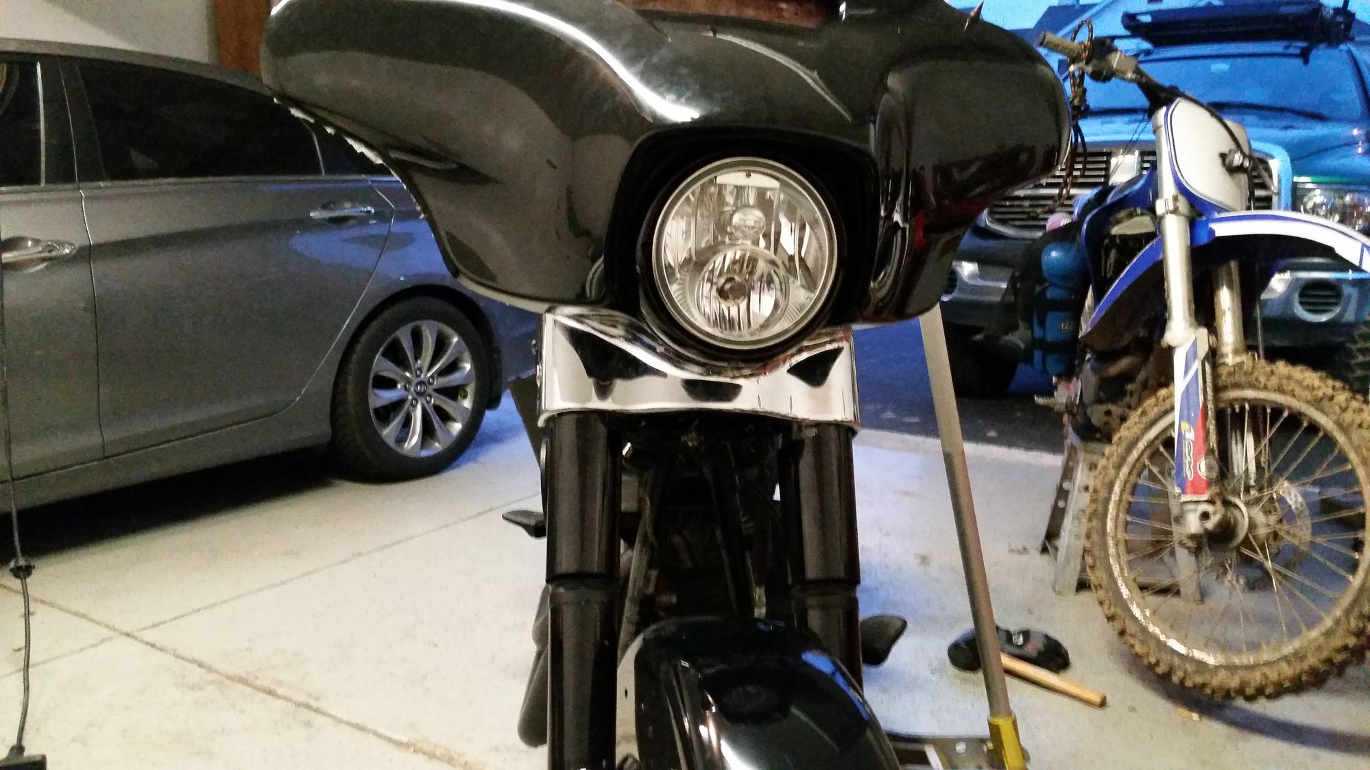

How far back does your headlight sit into the fairing? What does your mounting block look like? I just put my 7" headlight on today with the block that came with it. It looks fine on the back but it's hidden inside the fairing when I mock the fairing up
After a bit of cut, mount, cut, mount, cut and mounting of the light and the bracket I purchased from headwinds (linked below) I got the 7" light to sit where it looks like it belongs stock. Here are some pic, profile of the the light under the fairing, pic of the bracket (best I can get) and one of that shows how I modified the bracket. Hope these help.
http://www.headwinds.com/mm5/merchan...Category_Code=

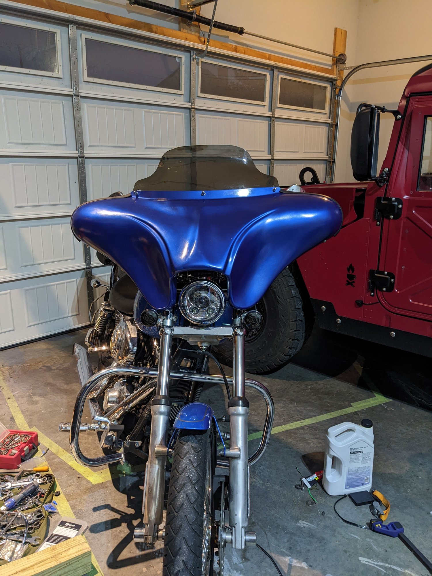

Fairing and engine guard on my 2002 Dyna wide glide
