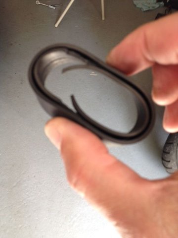

Originally Posted by GeorgeJ
Based on the mileage and year - I've got an '01 also - check the manifold rubber ring behind the card - in-fact check the other two rubber rings going to the cylinders. Mine was split and left me stranded. Easy fix -
George
Thanks George. Would you be able to take a pic of exactly which one you're referring to? I'm still learning.
