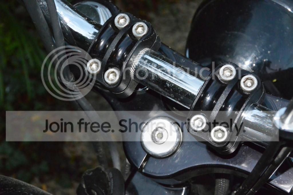

Running 18" apes with individual clamps. No issues so far with a couple thousand miles on this setup. You will definitely want to go with poly bushings in the triple clamp.
