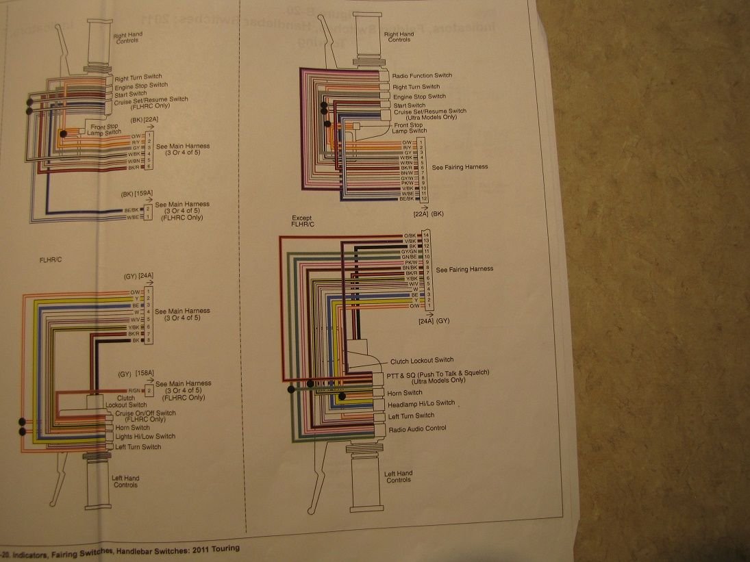

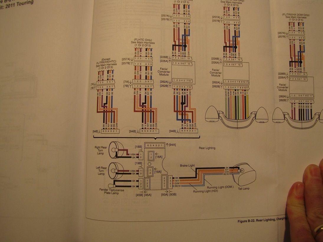

You can unplug the connector to the switches and ohm out the switch, Right Handle Controls connector 22 or the rear brake switch which I think you replaced. If neither is stuck closed pull the connector at the light #93 and see where you have 12 V. Could also be a ground issue?
