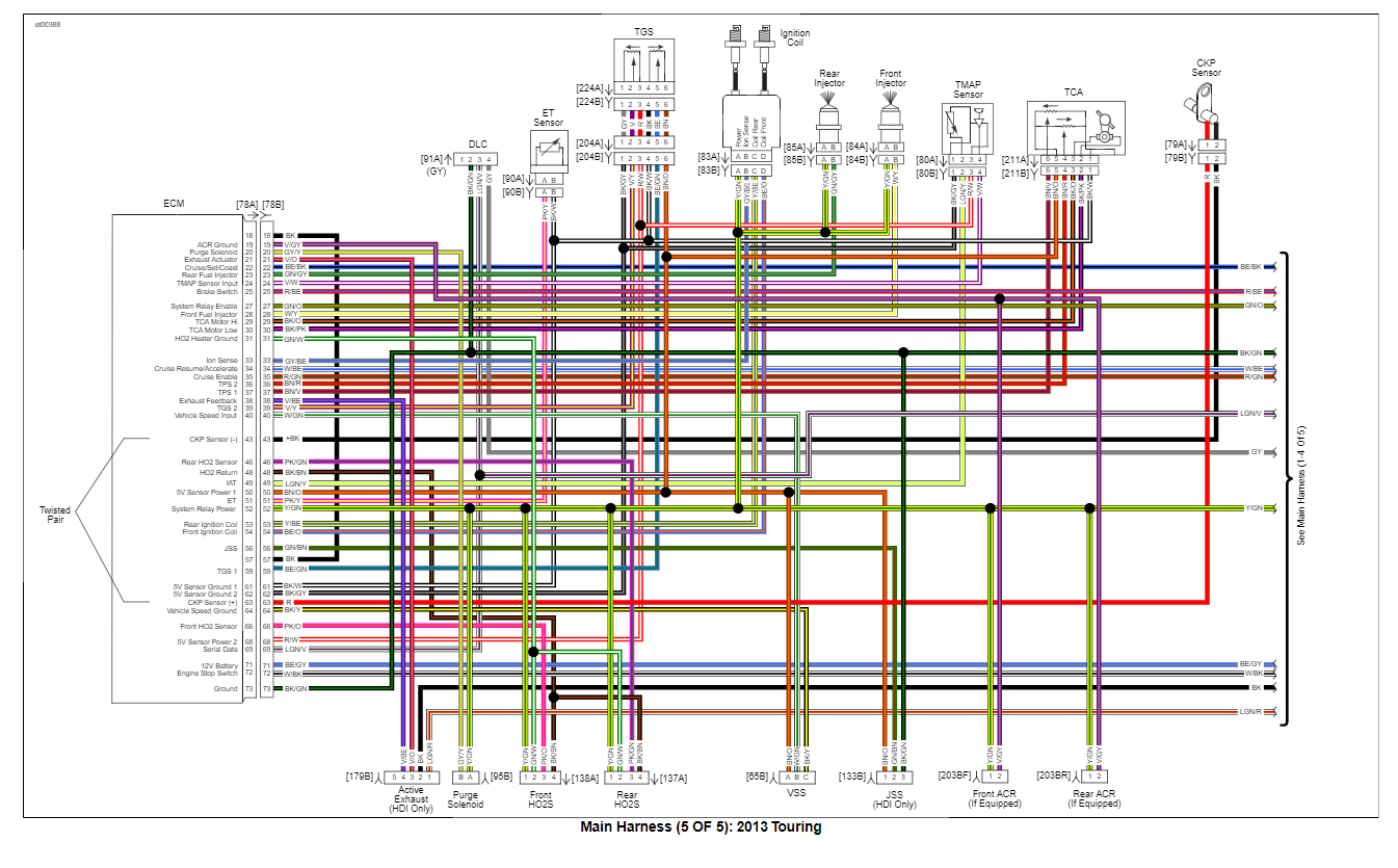

Check your system relay, and by check it, I mean replace it and see if that helps.
Y/GN wire is from system relay, directly powers several things, and also ECM

if the map failed, the engine would run off the burned in fuel curve and basically the engine would go into limp mode. that pretty much tells the ecu to ignor other input. i run gravity and gravity never fails but of concern is the data buss, without it working, the systems can not communicate. i rarely fool with the stuff to really remember the modes of h/l on the buss. going from other systems, i believe it to be a high signal from ecu to an addressed sub-component allows it to communicate, this way, the ecu controls which component is talking and not walking around in a crowd of data.
it could be almost anything from bad connection to failing component. the fsm electrical will be your friend.
