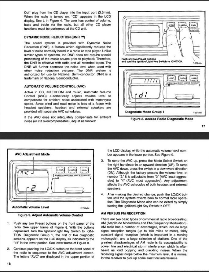

Automatic Volume Control (AVC) adjustment procedure.

Thank you will try this.

I have tried reprogramming the radio several times. No matter what I do every time i pill in the clutch the radio goes full volume. Cant figure it out. Any help would be appreciated.

I have turned the avc to 0 which im assuming is off. Every time i pull the clutch handle in the volume increases. Not sure if it is a bad switch or what.
