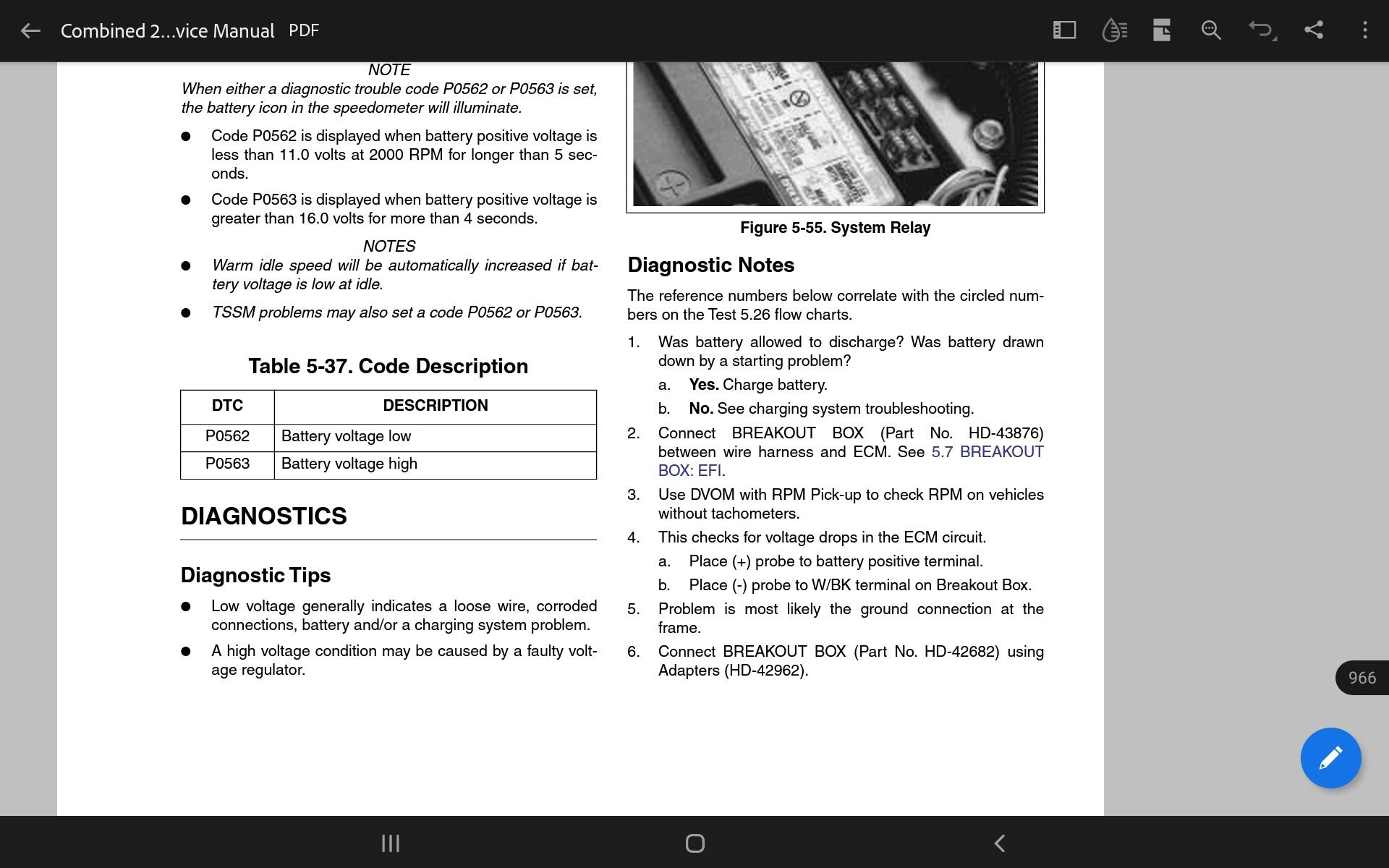

Check the voltage at the ECM fuse, that is where the ECM is reading the fault from. For P0563 most likely culprit is the VR. For a P0562 it could be connections, etc.
