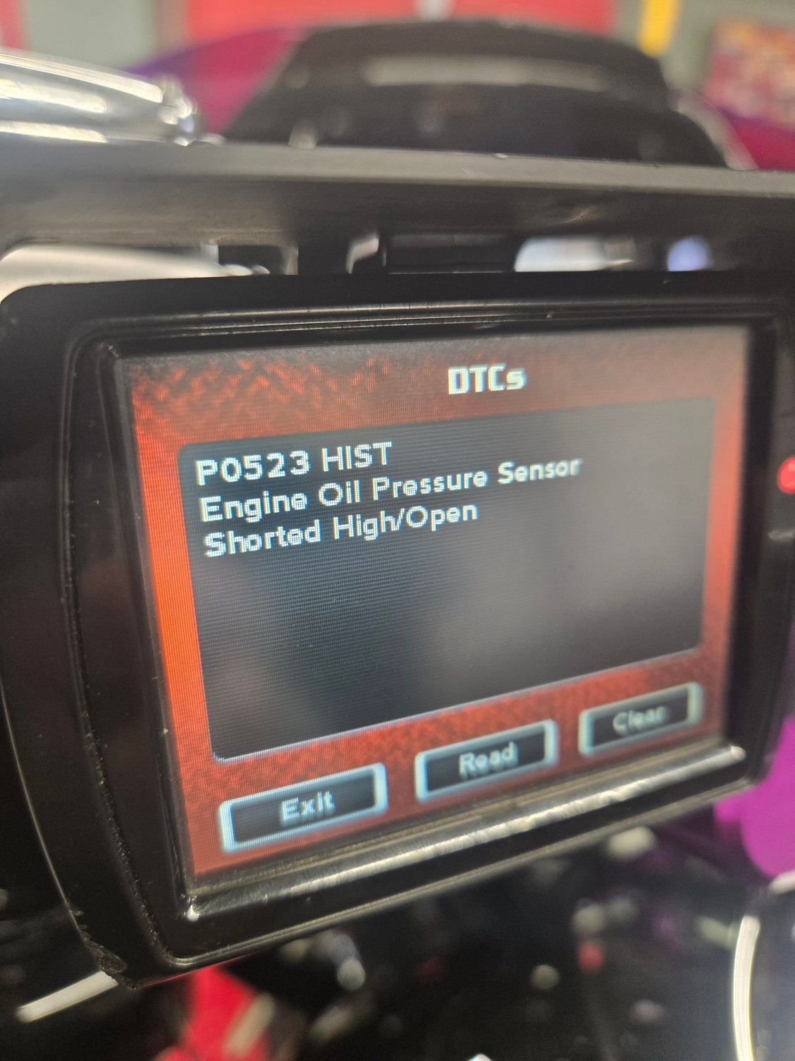

Getting a recurring P0523 code on my 2017 HD Road Glide. Have tried to clear code and it comes back on restart of bike, have replaced the oil pressure switch its talking about, connector seems good going to the pressure switch. Not sure what to check on the wire side of things besides breaks or stuff like that in the cable... can I test continuity from somewhere to that connector? Or any other ideas? I have already checked grounds on bike and they are all snug and tight. Thanks!

Just for grins, I would pull the codes from the bike and see if that code is there. Reason being it’s showing as historical on the PV.

Ha clearing in the gauges cleared it out permanently! Thank you for the advise never thought to try on there.
