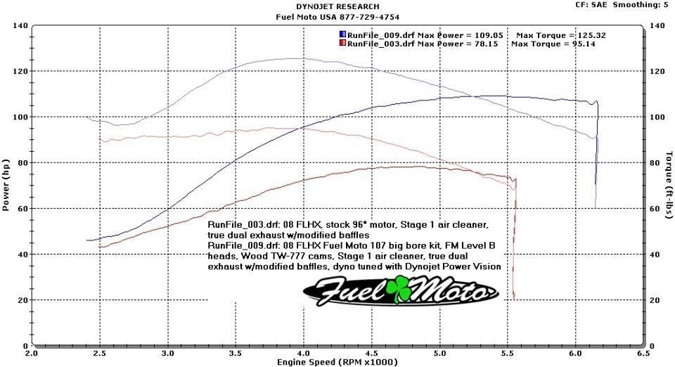

Originally Posted by Big Money
They are the style that the rear pipe sharply bends and exits the left side.
i would run it as is then, here's my brothers chart with similar/same head pipes and bassani slipons with baffles shortened to 7"s
it runs strong

Appreciate the info, If I can get numbers close to your brothers and a similar torque curve I will be happy. Basically I'm doing the same build with a 50mm SE throttle body.
