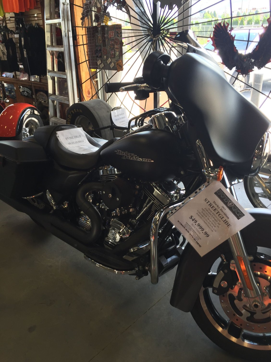

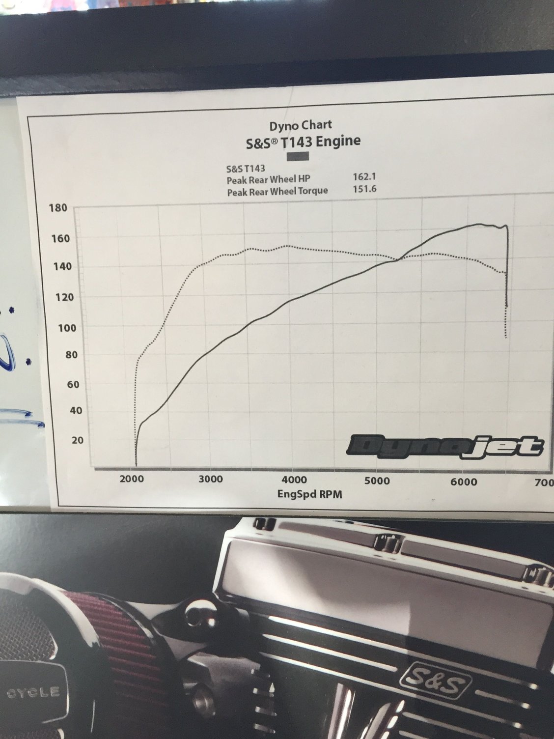

Great choice of engine! It is on my wish list for X-mass With the welded crank and timken bearings it is a solid power plant. There is a local speed shop here in western Canada that deals in S&S and they have the first t143 cu in a 2012 streetglide in BC. It produces over 100 ftpds of torque at 1500 rpm and around
160 hp at redline lol

That is 100 ftpd torque at 2500 rpm. My bad

One member offered to me that i could expect to have to get an upgraded belt drive, Baker trans, chain rear drive... probably why that bike in your pic is $50K.
Here's a link to that - Look for Dodger413:
https://www.hdforums.com/forum/touri...e-modding.html
I've talked to 10+ guys so far that have done the 124 switch - They are all running stock trans and belts with no issue. What year was that bike he was talking about do u know?
2012, if i read it right?
