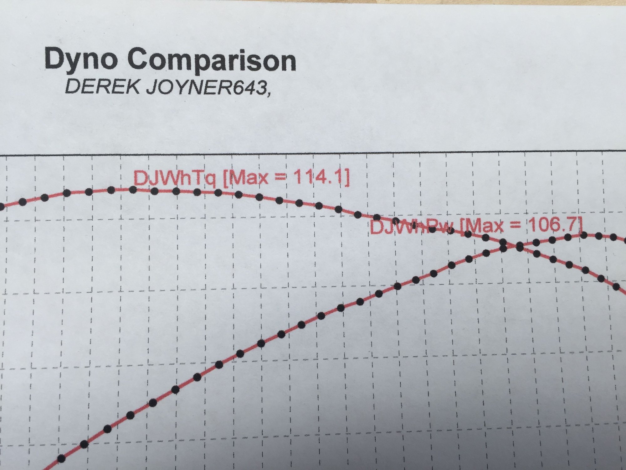

I swapped to Woods 777's in my Stage 4. Here is Dyno.

That dyno graph with thoes 777 looks real good...wonder how the woods 5-6 would do in my setup
