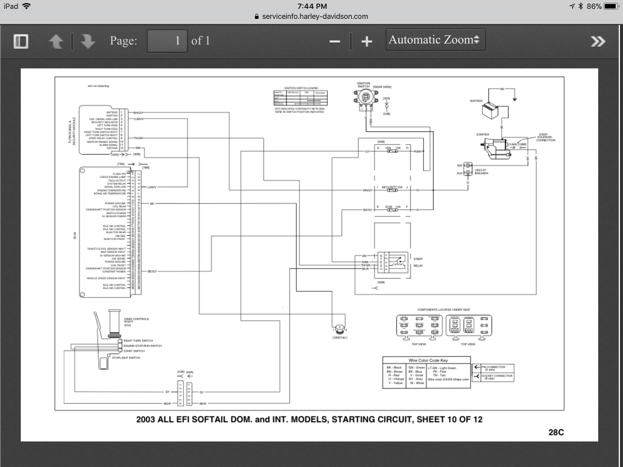

This site has schematics.
https://serviceinfo.harley-davidson....0f1bfaf2!!1!12
