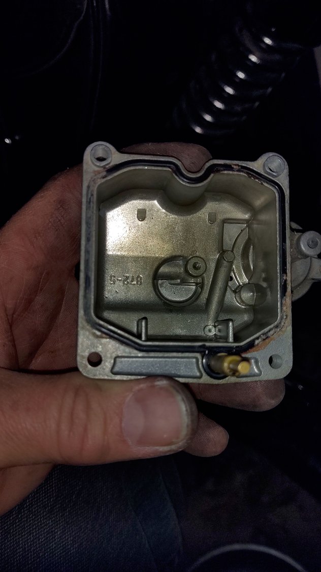

After mussing with the a/f mix for a bit I realized it wasn't going to. I was around 3.5 turns out and it would still cough and stall if I cracked the throttle at idle. So, a quick trip up to speak with the good man at J&R Engineering in Grand Rapids saw me leaving with a 50 pilot jet on his recommendation and two new plugs.
Don't know how this wasn't leaking.
A few hours more than I care to admit later I had the a/f screw at a "default" 2 turns and was out running it in 36°F at 10 o' clock at night. Usually it'd take maybe 5-10 miles to be able to shut the choke all the way off without it coughing on acceleration and stalling at idle, this time I was less than a half mile out with the choke off. Promising start.
