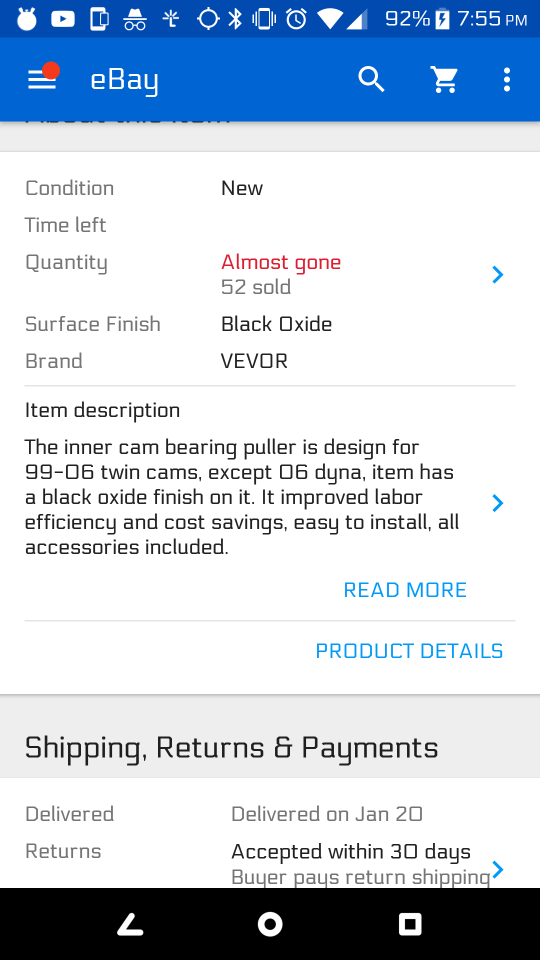

OK, that answers the question. I took another look at the first picture you posted, zoomed in for a closer look. Based on your comment that the "bearing puller is to large" and "hammered into the old bearing" I am wondering if you just have a mis matched plate vis the puller or perhaps the kit is for the later models with larger inner cam bearings. The early models have inner cam bearings that are .875" ID but the later model inner cam bearings are 1" ID.
Also remember that the collet must be fully collapsed and even then, it will require a push to go into the cam bearing; not a hammer but a little nudge. It won't just slip in as it is supposed to flare out once through the bearing ID to the collet flange can grab the outer cage of the bearing.
it says it's for 99-06
I leaned on it and I can feel it wanting to start going in, but it springs back, I think if I tap on it with a mini sledge it should work it's way in. I have one around here somewhere... Also have a hide hammer and a rubber mallet, it's not as heavy as the little sledge but it might work.
I have the cam plate in the freezer right now. Doubt the cam will press out by hand. Debating getting a hydraulic press, I have access to a couple of them but I don't like to wear out my favors.. I also might.have a bottle jack floating around, if I can get it under something straight enough I could push it out with that...

It says 99-06. I leaned on it and I can feel it wanting to start going in, but it springs back, I think if I tap on it with a mini sledge it should work it's way in. I have one around here somewhere... Also have a hide hammer and a rubber mallet, it's not as heavy as the little sledge but it might work.
Can't argue with what it says but it should not require any hammering; maybe a tap but no more. Make sure the collet is threaded out far enough that the four jaws will totally collapse inward. If you **** up and knock some of those little rollers loose and they fall into the crank case you will be hammering your head against the wall.

The biggest reservation I have with it is that the end of the puller doesn't have anywhere to put a wrench to keep it from spinning. I'll be hammering my head on the wall if I get it on there and can't get the dang thing back out again!

I looked at the picture of the tool parts again and I think I understand what you are saying and we have not been communicating very well; I have been out in the weeds.
The puller does not have a "head" that will accept a socket or wrench so there is no way to press the puller/collet into the bearing bore. I think you have two choices; send the tool back for a refund or use two nuts of the appropriate size/thread and double nut them onto the threaded end of the puller. Once the two nuts are locked against each other, the puller can be run into the bearing bore and when the collet opens up on the backside of the bearing, unlock the two nuts and thread one of them down against the plate and use that nut to pull the bearing.
Most other tools, like the Heartland tool everyone has been referring to includes a puller with a head that will accept a socket or wrench.
