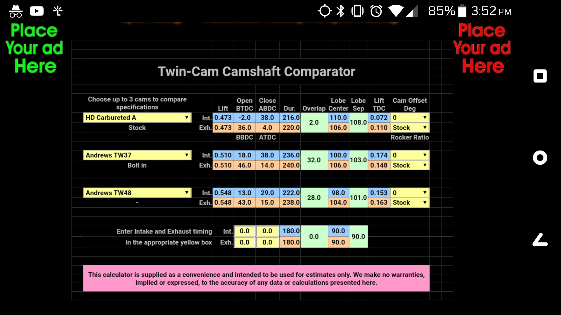

I was looking at the Andrews 37

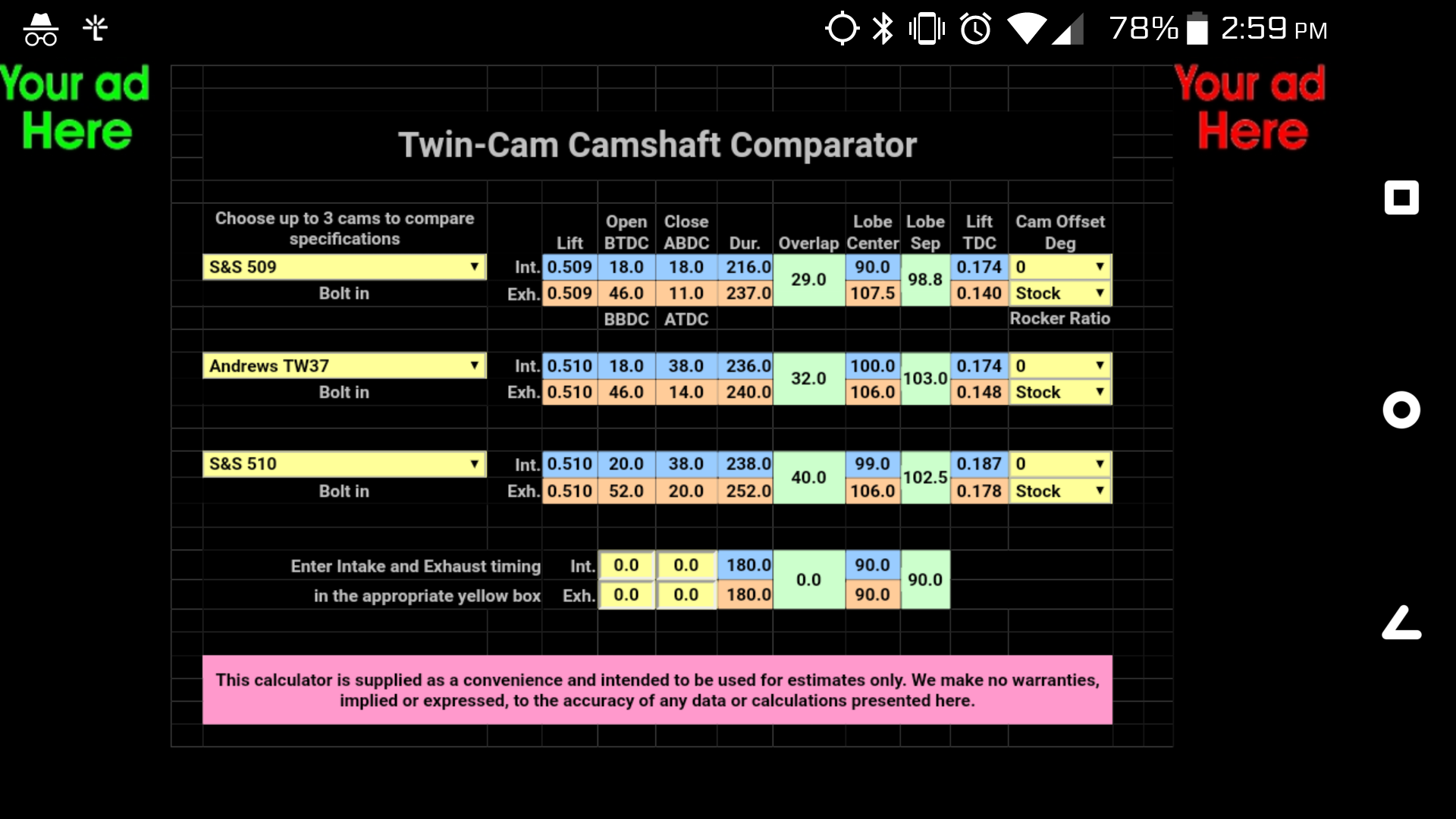

The 37 looks comparable to the 509 and 510
It shares a lot of the numbers with the 509 and 510, but might split the difference between them?
Stock, 37, and 48
I'll think about the 48. I don't know if I want to mess with swapping the springs. But I might. Otherwise I'll probably go with the 37

The 37 will be soft on the bottom in a TC88; late intake close. The number in my previous are peak numbers and don't reflect partial throttle response; the OP will regret installing the 37. The Andrews 26 or the S&S 509 are the two best choices for the OPs application.
The Rivas 514 will probably work with the OEM springs but should be checked for coil bind but it will be soft on the bottom as well with a 36* intake close. The OEM springs will not accommodate the .554" lift.
The 48 is not a bad option with the 25* intake close but springs would have to be changed to the '05 up beehives. JMHO but the 509 would be the best choice for low end to mid range power.
