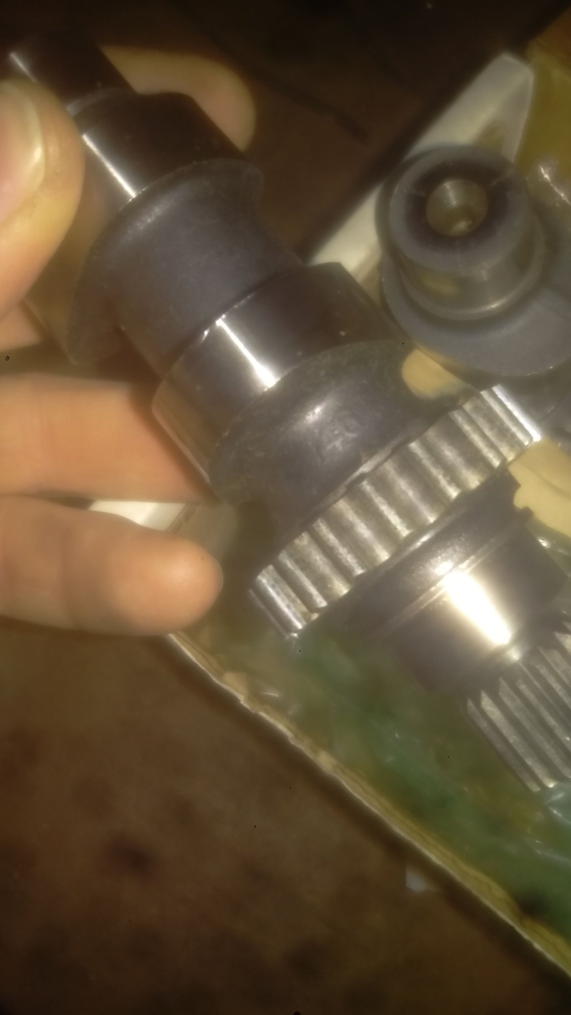

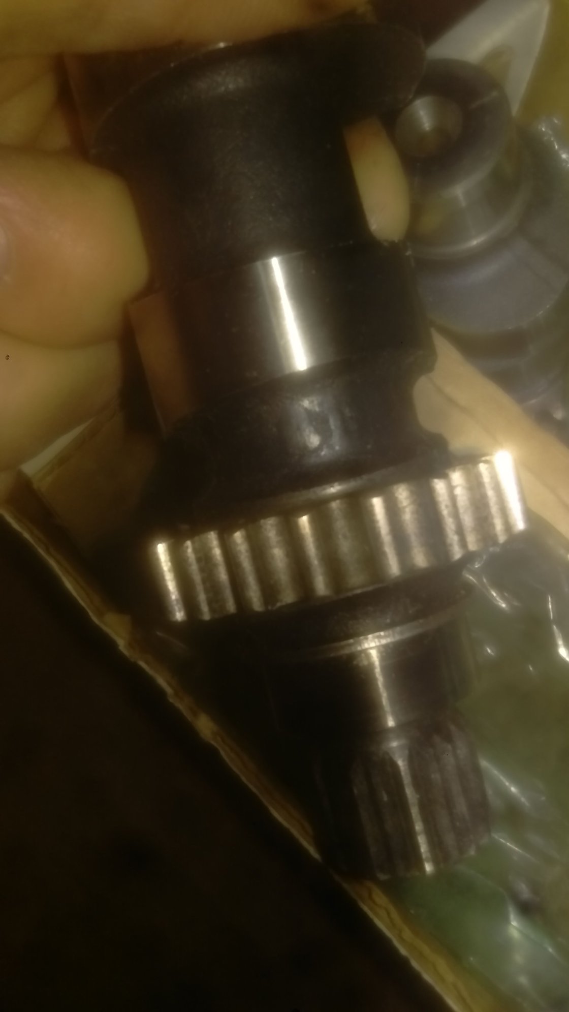

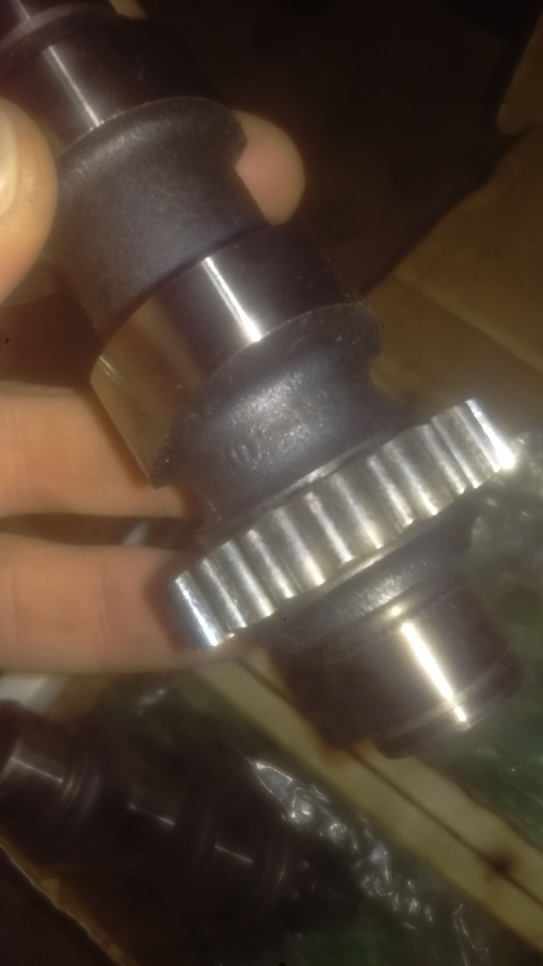

Originally Posted by djl
If the cam is an SE204, that will be stamped on the face of the outer bearing journal, easy to see.
No indentifying marks on the end
Or this end, if anything it looks a bit chewed up, does not look like NEW Old Stock at all :/
There are some marks cast in "46"
"AL"
Then on the other "AG"
And "49" might just be generic markings for the blanks..?
Wtf did this guy send me!?!
The cams that came out of the bike that got your 204 cams
I've seen this **** a lot. People put OEM shocks into the Progressive box and some horses-*** tries selling them as Progressives on eBay.
"AL"
Those appear to be stock cams.
