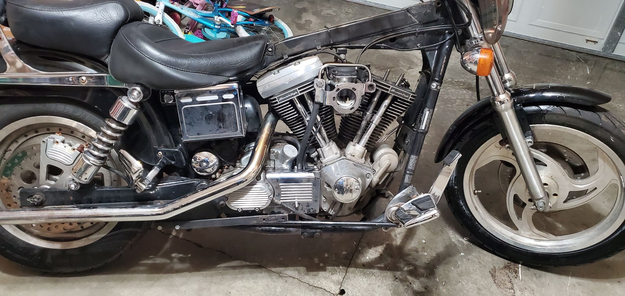

Can anyone help me identify this engine?
Old Mar 24, 2020 | 07:46 PM
98hotrodfatboy's Avatar
98hotrodfatboy
Posts: 21,114
Likes: 7,638
From: Poolville
Lifter blocks tells you it's an Evo engine, vin says post 92. What's inside is anybodies guess till it get opened up, 80" 88" 95" could be any of them and look stock on the outside as in the pictures.
That's what I love about my Evo, 96" on the inside and looking stock on the outside.. Yea baby...

Likes: 7,444
From: OH
understood but there was speculation that it was a hybrid with tc top end
Old Mar 24, 2020 | 08:29 PM
TwiZted Biker's Avatar
TwiZted Biker
Joined: Mar 2009
Posts: 66,122
Likes: 51,431
From: Niles Canyon Ca.
Couldn't be, valve train alignment is different between the 2 engine designs. Get a clear side view of both engines and look close at the lifter blocks and the angles on the pushrod tubes. While it could be done, it isn't a simple bolt in swap. Lotta **** would have to be reworked and a few things the cam special made to get it to work right.

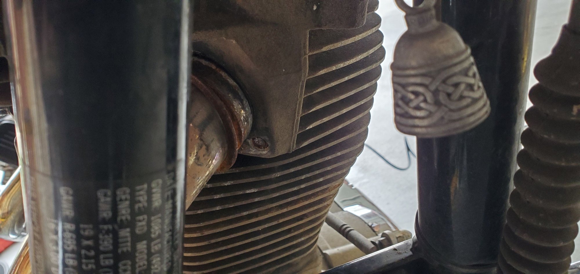

Current state of this mess... Working on getting to the point I can try to get the broken stud out, or take it to a machine shop once the virus stuff ends...
EDIT: Also, do I need to buy all new gaskets for everything due to disassembly?

Originally Posted by Mattbastard
What broken stud?
The broken stud on the exhaust port.
