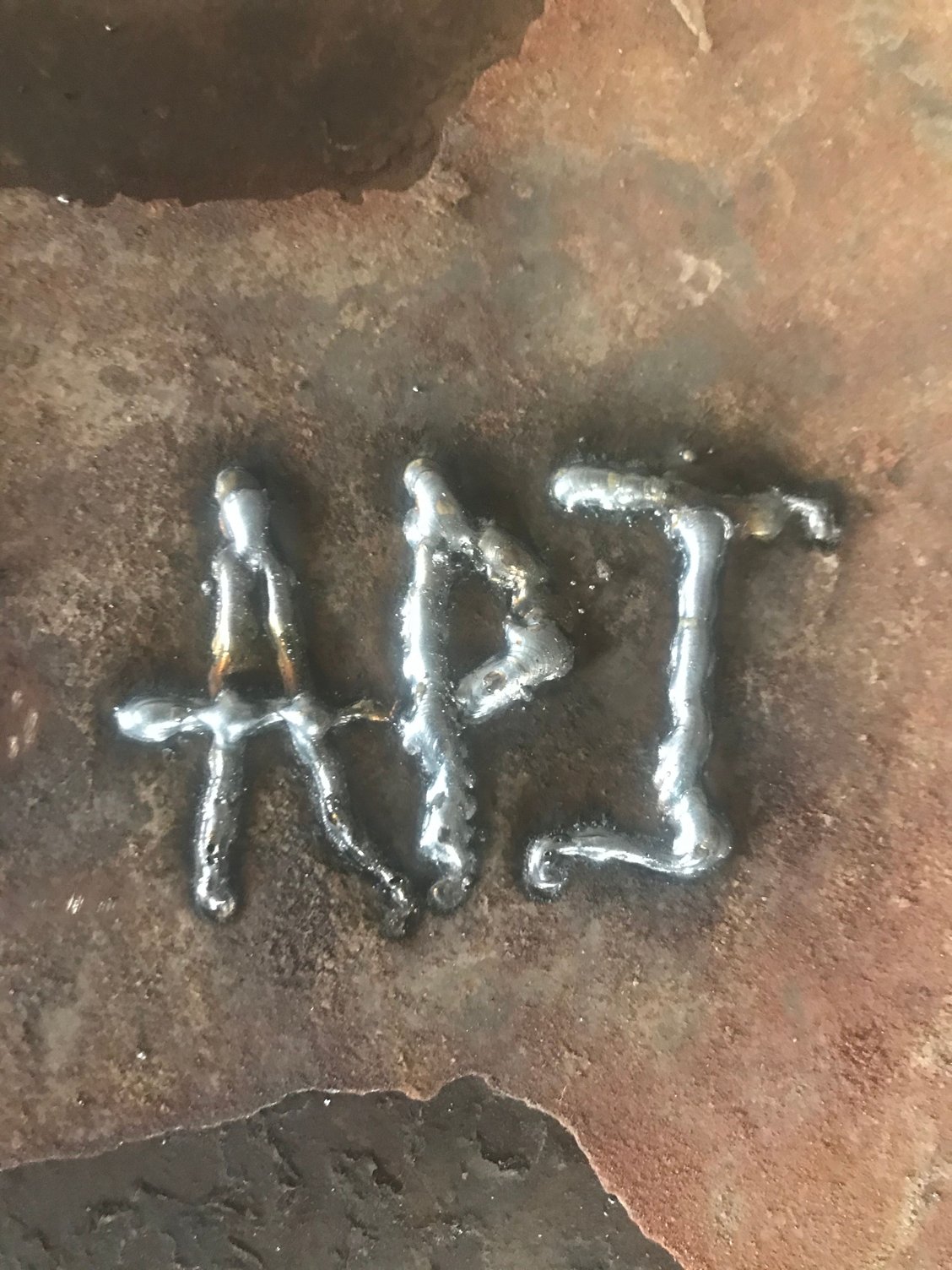

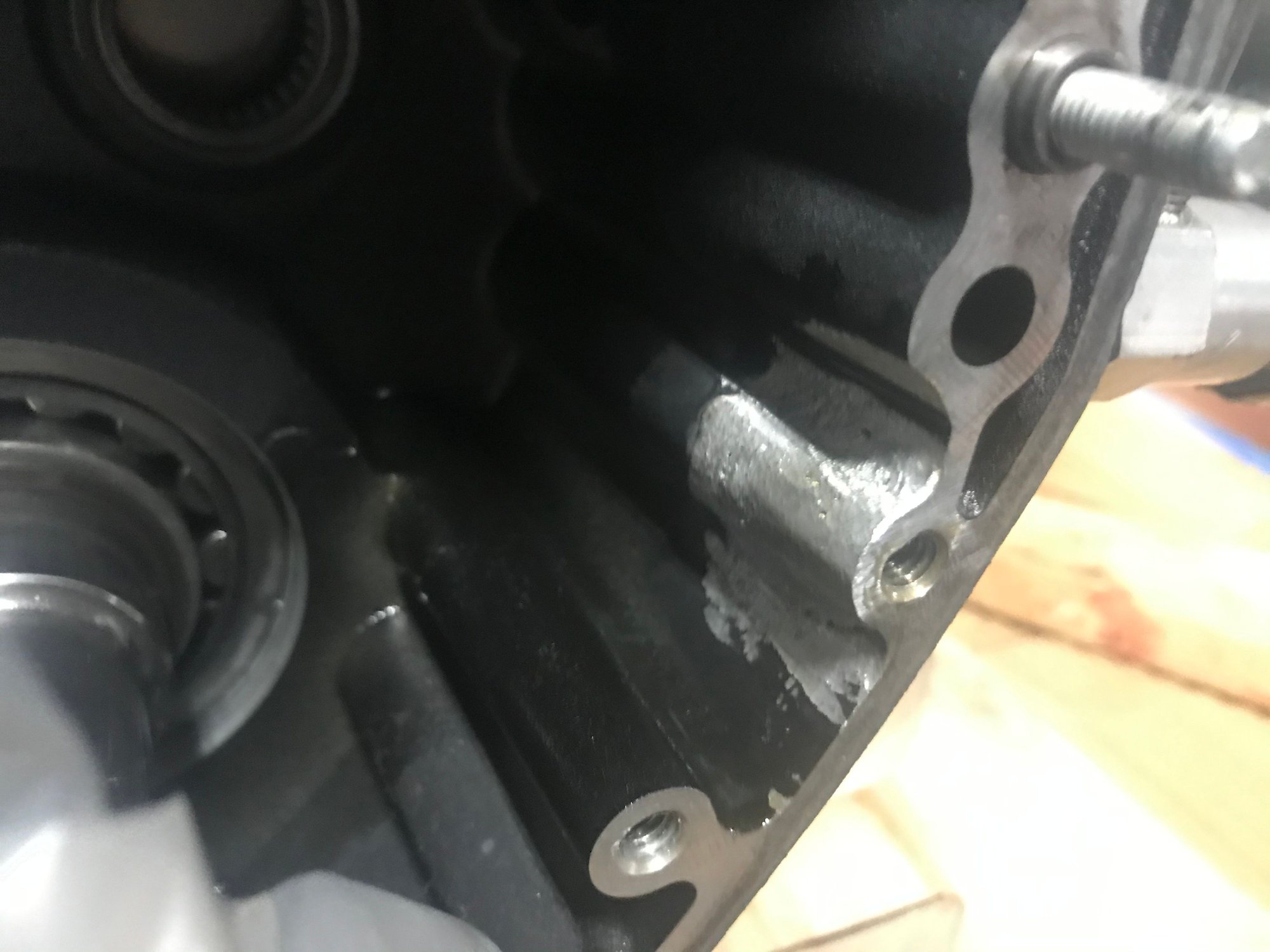

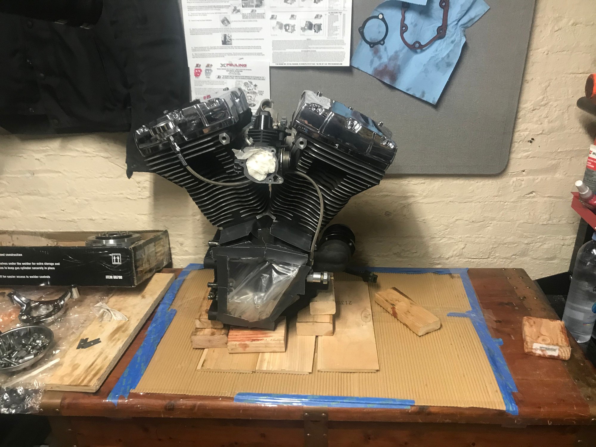

my buddy who lives 3 hours away has a serious setup and he let me use it I ran some practice runs on a junk aluminum intake manifold for a Honda Civic then just got to it ! I couldn’t have ever trusted epoxy and I’m glad I just ripped it apart and handled business also picked up some crane roller rockers at a steal to replace the ultima rollers I was running so now it’s back to stock rocker arm ratio with the cranes and new Andrews 48s in conjunction with a beefed up primary and some other things as well !
This is the finished product
Made some test passes with the mig before switching setups and jumping on the spool gun
It’s a workin progress if it’s clean then I’ve got nothing to do and thats when the legal cost pile up 😈
There it will stay until the crane roller rockers arrive but I’ll take the time to clean her up a bit
Good as new with the acceptation of the missing powder coat you would never know she was cracked !
